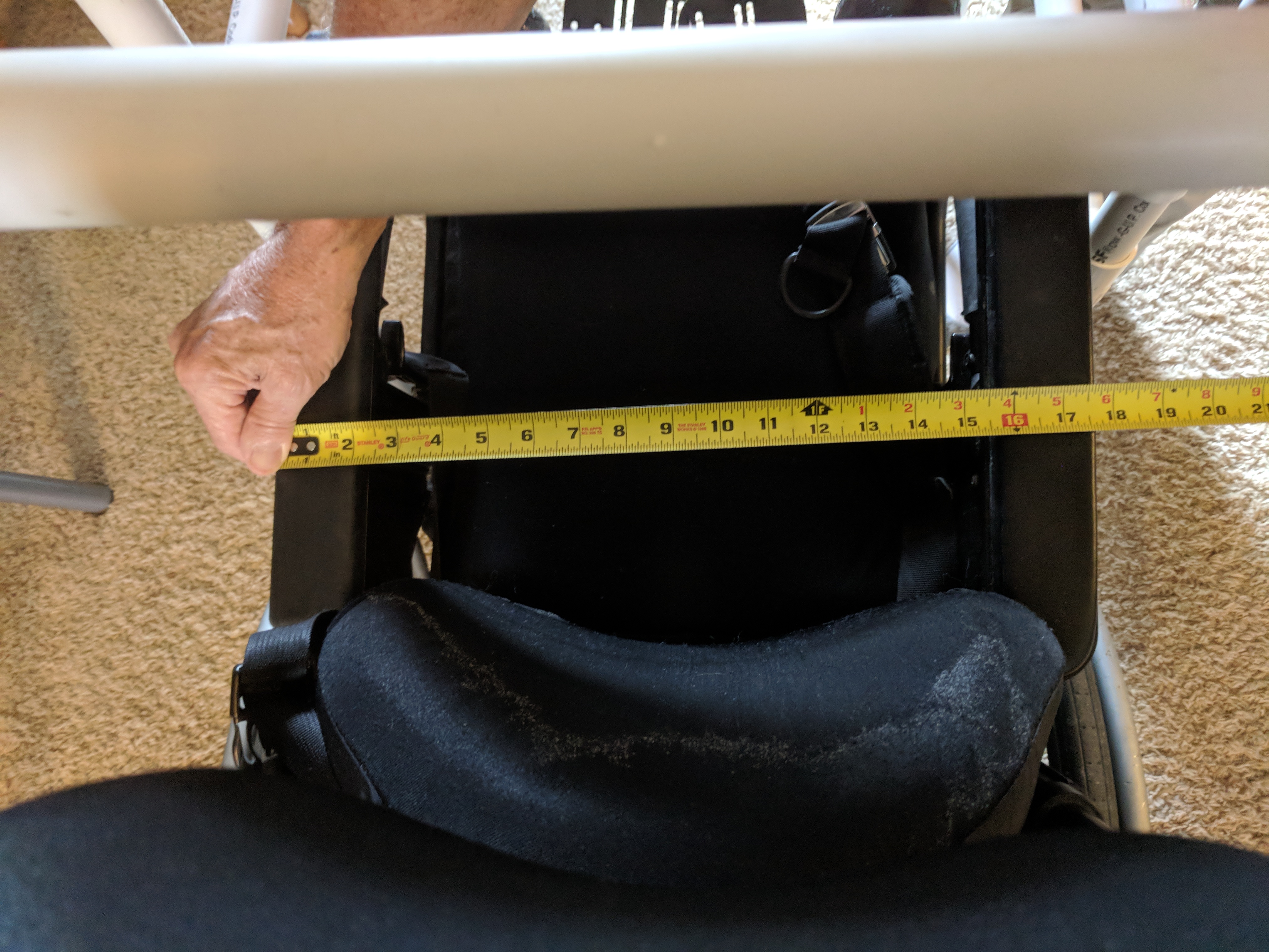

You need to look at the foot rest to see if there might be some way to attach support for the hood. It looks to me that we will need some kind of brace to support the nose weight.
The furthest thing touching the ground on the wheelchair is the front wheels themselves, so that will be the pivot point for weight tipping forward. I’ll check on the foot rest, though. I believe that Logan uses them when in the chair. Are you thinking that the structure of the chair isn’t rigid enough to attach only on the armrests?
I was looking for other options just in case we had a balance issue.
Probably something we’ll need to watch, for sure. I’m thinking we’ll have some control over weight by where we put components, especially the battery or batteries, although I hope that the total weight remains pretty low.

We’ll definitely want to keep an eye on that issue. I thought I might bring our mock-up along today to compare it with the actual chair.
