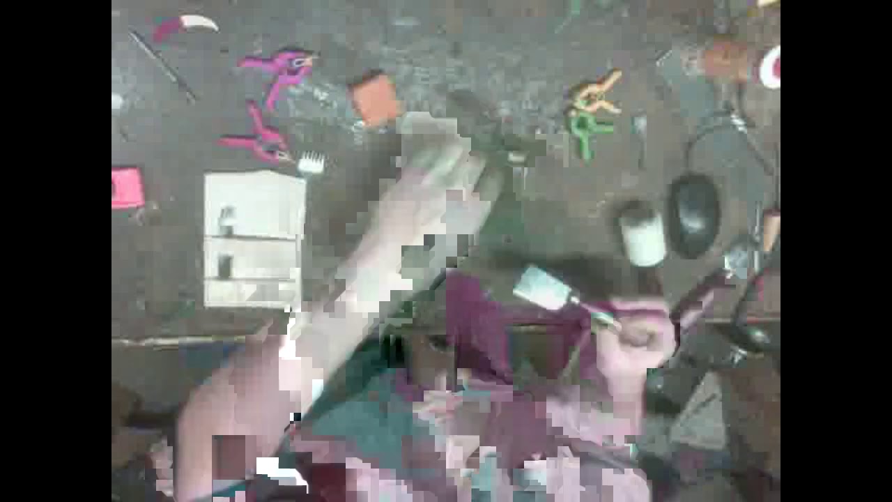

I think I went with an MP4 and adjusted the frame rate. The webcam isn’t the greatest so the quality isn’t that great. but I only have two subscribers anyway. I compiled the video in openshot and even put a fancy pants opening title on it. Video can be mocked here
Again, the container (MP4) doesn’t matter so much - the codec does. You’re using mjpeg, which compresses each frame independently, generating very large videos. Other codecs will store changes between frames instead, generally creating much smaller files. This is overly simplified, but if you still want to improve the quality/frame rate/resolution of your videos without generating giant files, try other codecs. It’s on the right side of your settings screenshot below the container settings.

I will most definitely look into various codecs. I did get a video of me making a project. I think the camera is part of the problem and I KNOW the florescent lights are a problem. But I did get a video, edited, and on YouTube.
