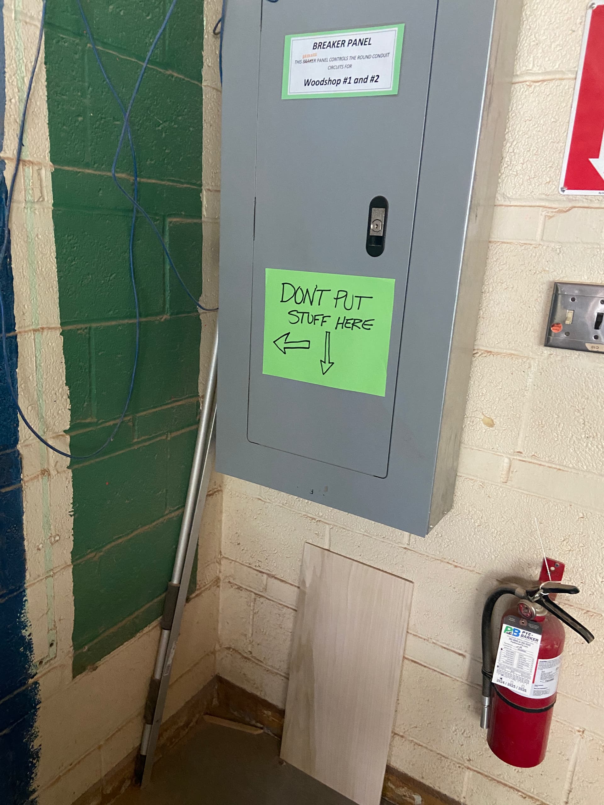

There was lumber leaning on front of the electrical panel tonight. It is my understanding that an area 36" in front with a width of 30" should be kept free of obstructions. However I might be mistaken. Can somebody confirm this? Should we tape off the necessary area around each electrical panel as a reminder?

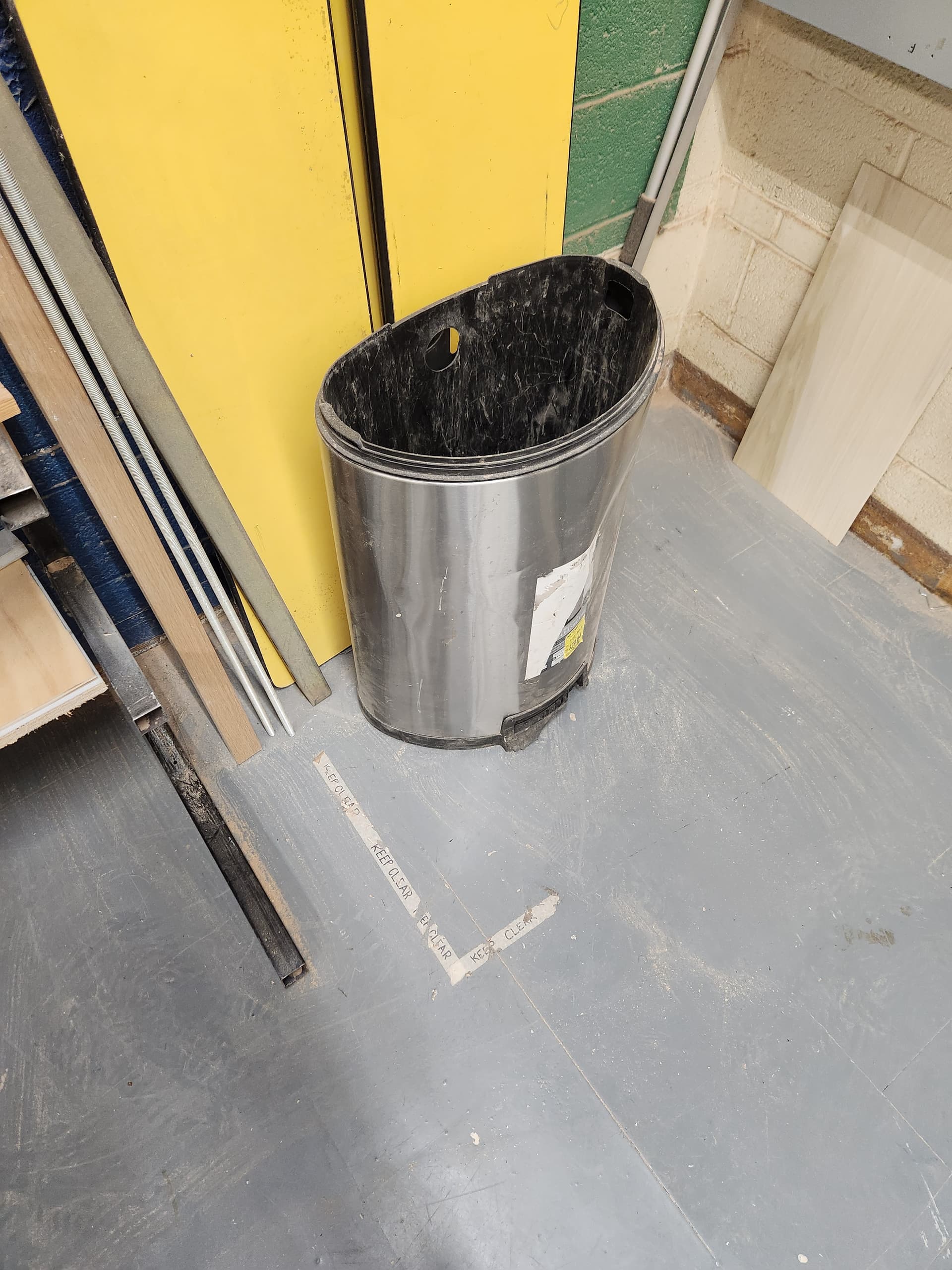

This has been an issue again lately. Tonight I moved benches and a trash can from in front of the panel in the wood shop. Don’t put stuff here!
