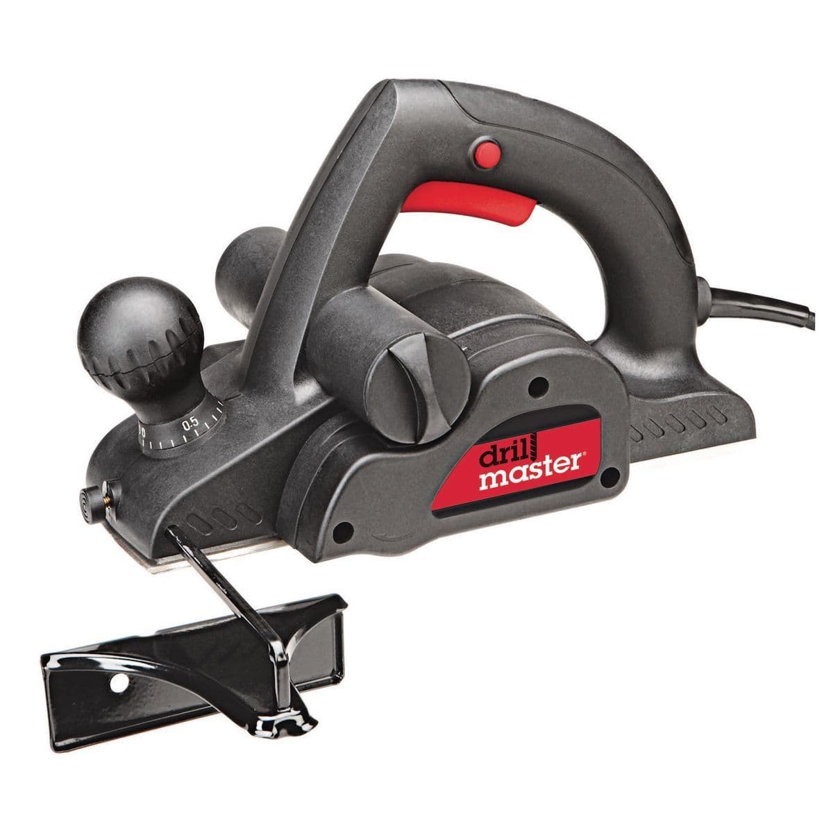

Nice work so far. Is it too wide to fit in the planer? Kind of hard to judge from the picture but it looks like it would fit. EDIT: Sorry I just fully read it rather than skimmed it.
The was a drill-powered (or something), homegrown one that wasn’t quite really ever up in recent history. There is a generously donated one that is currently keeping the boiler company while it awaits a dust collection setup.
Yes, too wide.
