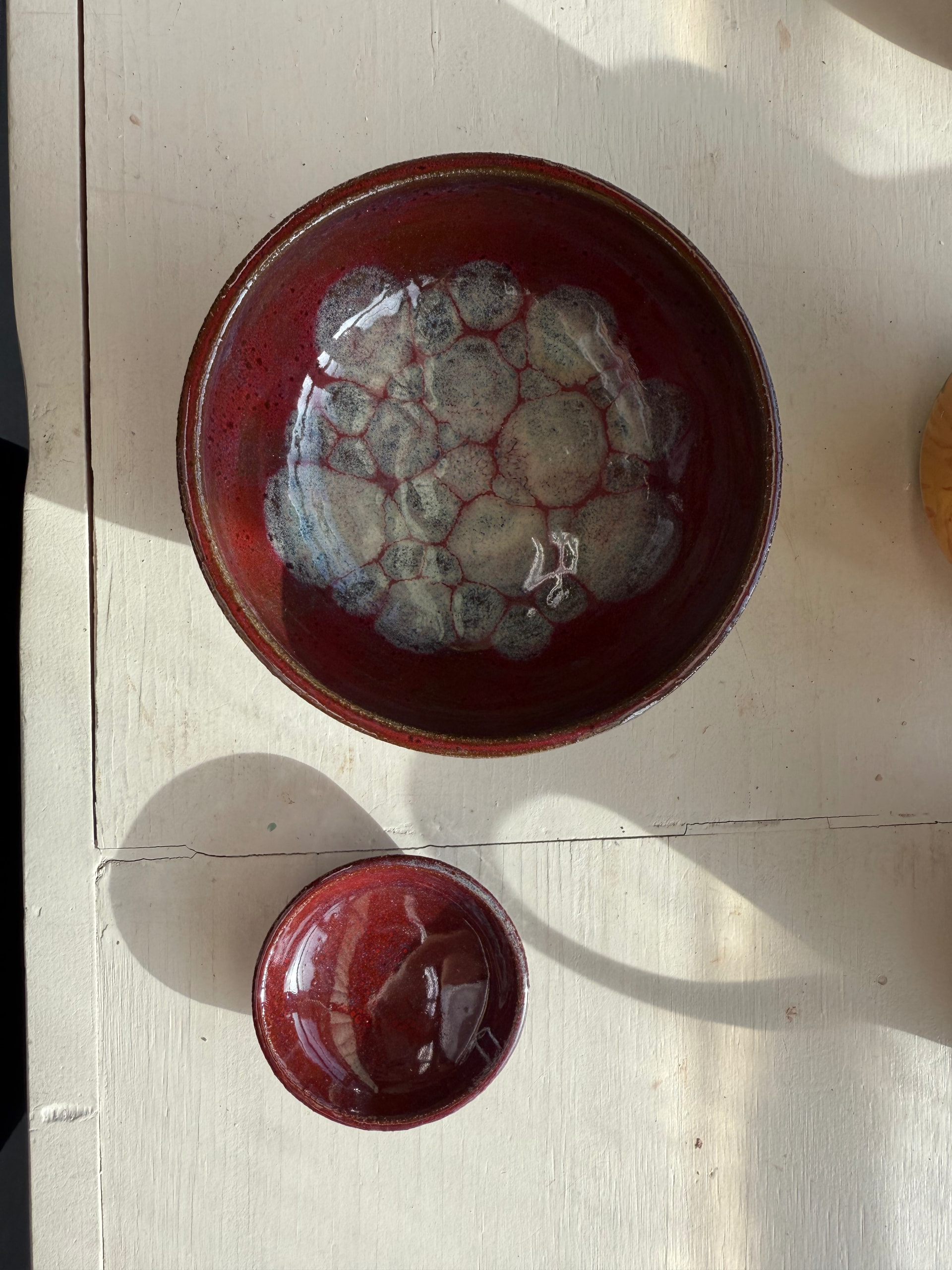

What glaze combinations?
Gorgeous work! I was wondering what glazes were used on these pieces?
Hi! Those are mine. I used Mayco cinnabar for the base color: 2-3 coats. Then for the white spots in the large bowl I did dots of spectrum running hot chowder(you can look up the frozen pond technique) and then I did a top coat of Mayco amber topaz 2 coats I think!
