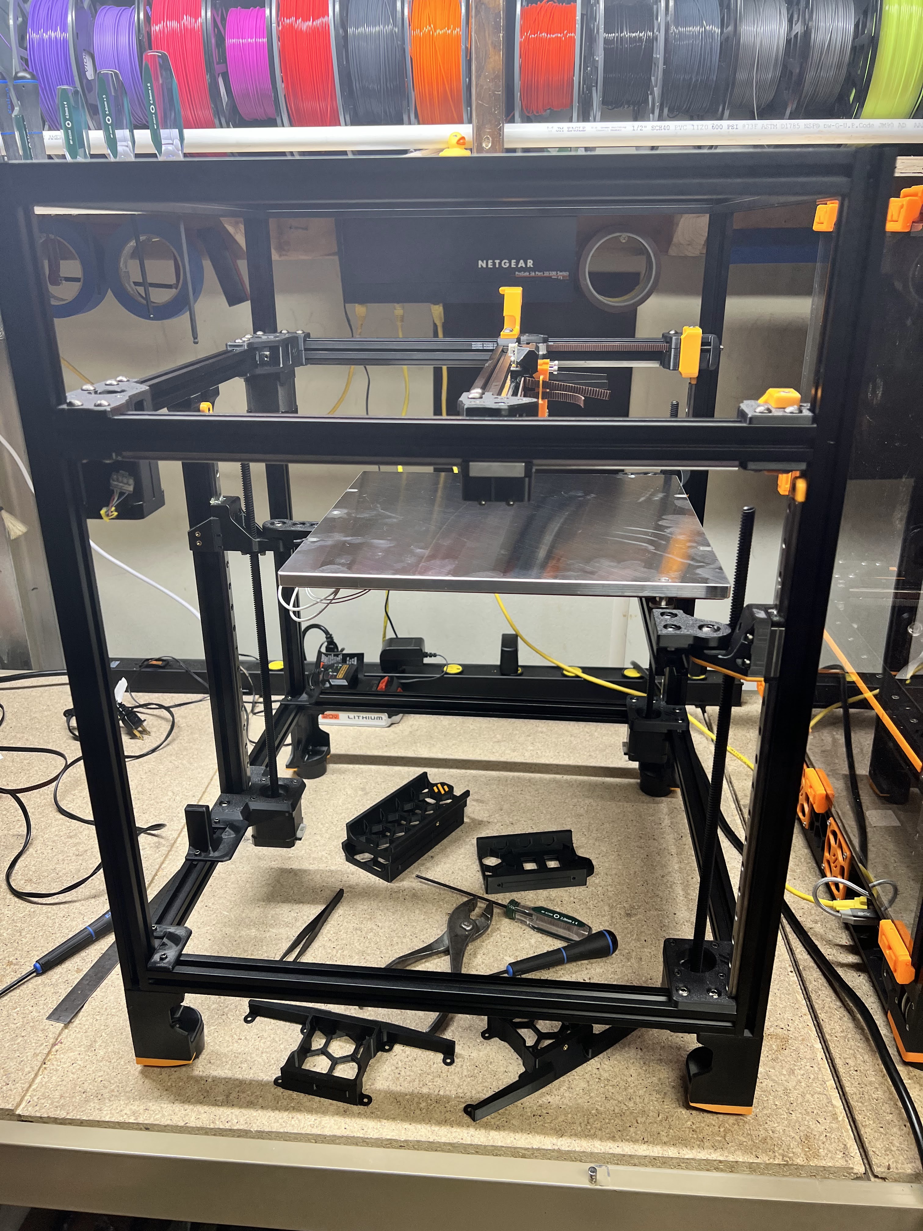

What is it, and what does it do? This is my 3rd Voron 3D Printer. This version is the Trident which is a Core XY printer with a Moving Bed on the Z axis via 3 Screws.
Why are you making it: I enjoy 3D Additive Manufacturing and love building machines.
This is the Frame, Steppers, Bed, and Gantry.
Stealth Burner Hot End with Tap, Cable Chains, Wiring, and Electrical nearly complete. I used an Inverted Trident Electronics mod to make for easier access. Large Printers get really heavy and it’s a pain to tilt them when needing access.
Touch screen display, Deck Plate, and Side Panels installed. I used another modification for the side panels for quick removal.
Back Panel, Nevermore Carbon Filter, Doors installed. I used 270 Deg Hinge mod on the doors to allow them to swing open fully.
Here is a nearly final view of the Trident next to my Voron 2.4 350MM printer.
