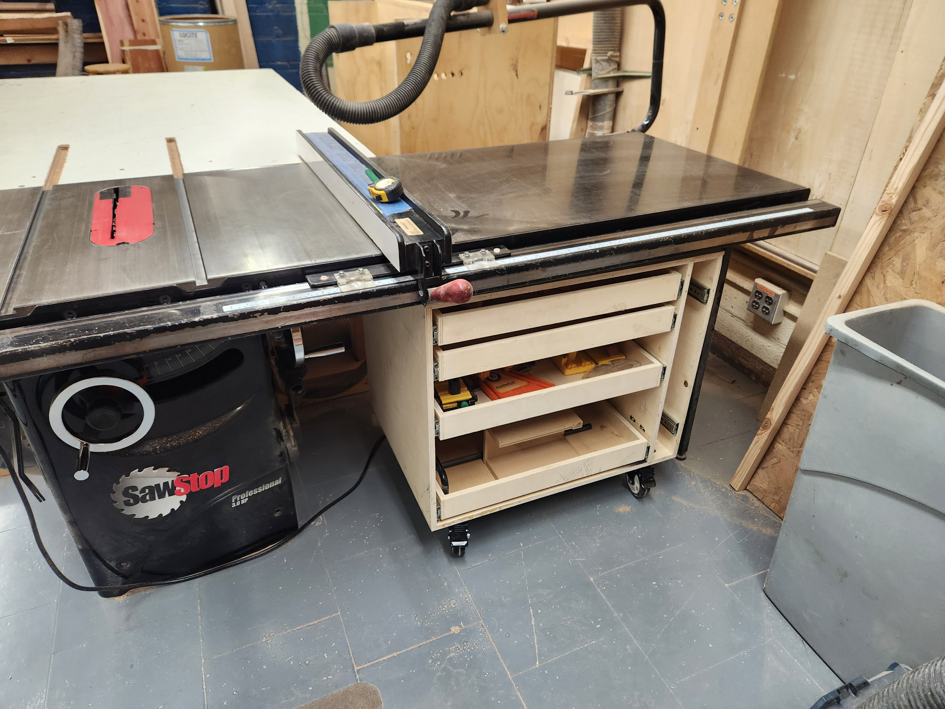

Finally managed to make time to move the tablesaw storage forward. Still needs the side drawer made and drawer fronts but should provide much more usable area than the shelf it replaced. No more stuff getting pushed to the back of the shelf and forgotten about. And with casters, it’s easy to roll out of the way to sweep! (Sorry it’s taken so long!)

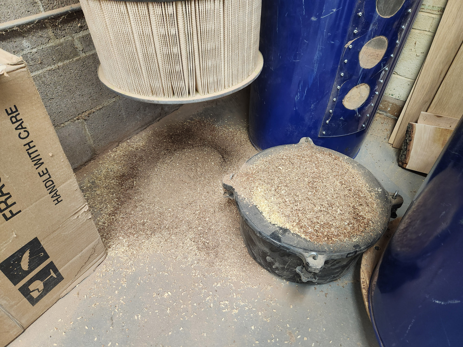

Since somebody failed to change the dust collector barrel, a lot of debris made its way into the filters. They needed to be cleaned anyway, but the filters had about a foot of dust accumulated in the bottom.

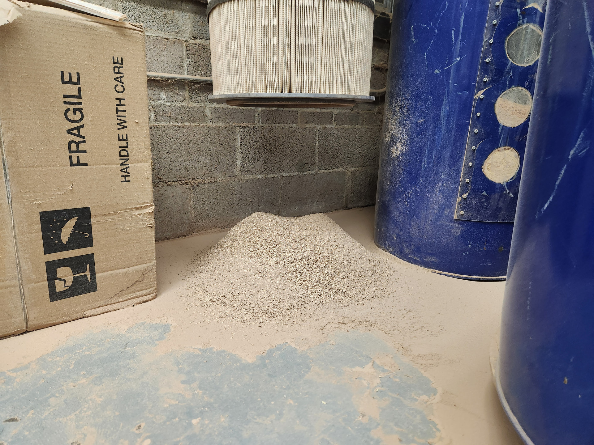

After getting the loose debris out, I knocked more dust out of the filter pleats.

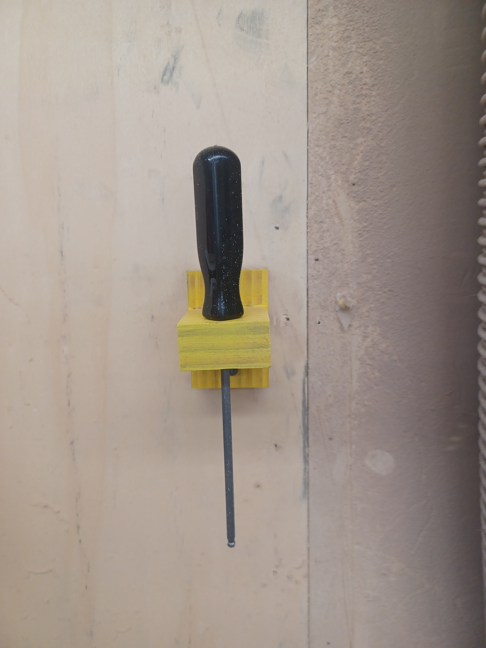

btw, ive recieveda new adjustment tool for the micrometer tool, i just need to drop it by, a sign should be made above a dedicated holder stating that it stays in the woodshop and should always be returned to its storage spot. Ill see if i can make a dedicated holded for it and would like to know if its ok that i attach said holder to a permanent location in the shop.

Bummer you had to clean out the filter, I guess you had to pay the price for someone’s laziness.
Thanks for buying another 3/16” hex key especially for the miter gauge. You keep calling it micrometer tool. I don’t know where you keep getting that name, since it has no micrometer adjustments on it. It is just an Incra miter gauge. I don’t care if you mount it somewhere with strict instructions to put it back where it came from.

ill put up my little tool holder, it’s in my car bouncing around and leave it at that. the other things were suggestions based off of observations. ive got a question pending an answer concerning dust collection elsewhere on the internets. I do remember that at the old location everything was hooked to the dust collector. as for slicing logs on the 1/2” bandsaw, there was a jig made for that. Ive always have run logs on the joiner to get two flat sides perpendicular to each other before slabbing them out. the blade alignment issue might happen when and if people pull back on the wood if they notice an uneven slab happening. it might be easier to show than to describe.
welp, here it is.
