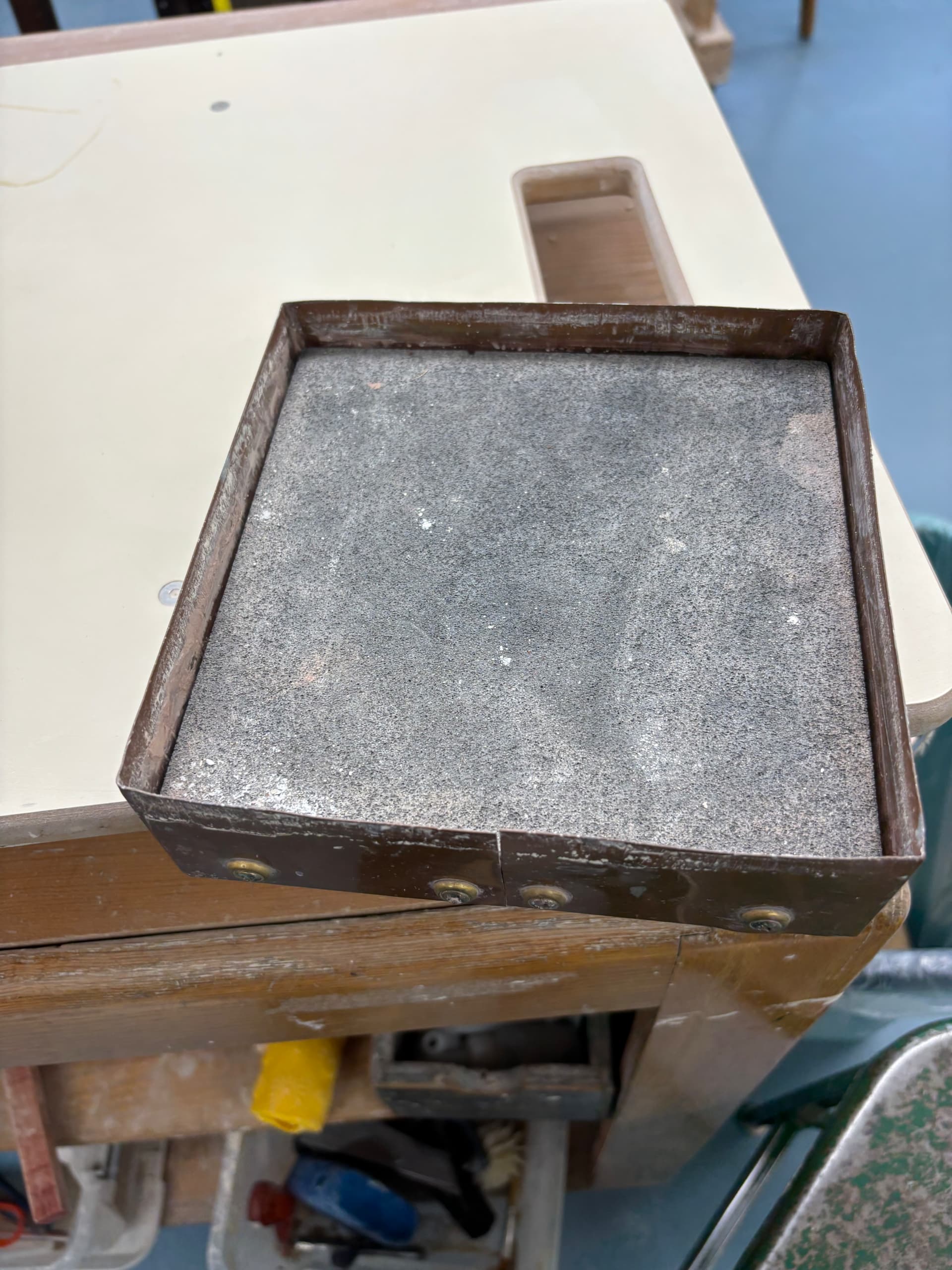

We have a tile cutter somewhere in the MakeICT ceramics room, it lets you get exact sizes. Also have sandbags to weight down the tiles so less chance of warping. Good luck!!
It is on the shelf under the slab roller. 7” x 7”
