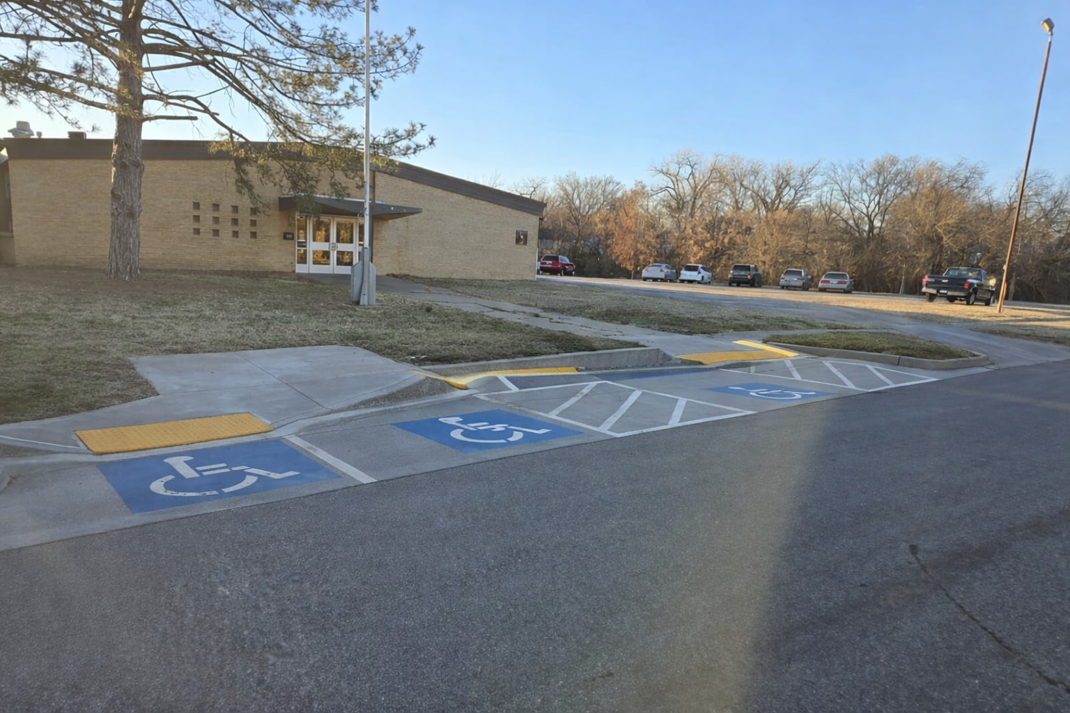

Thought I would have chatgpt add wheelchair ramps to get to the sidewalk. Maybe let’s not have chatgpt do the work when the time comes.

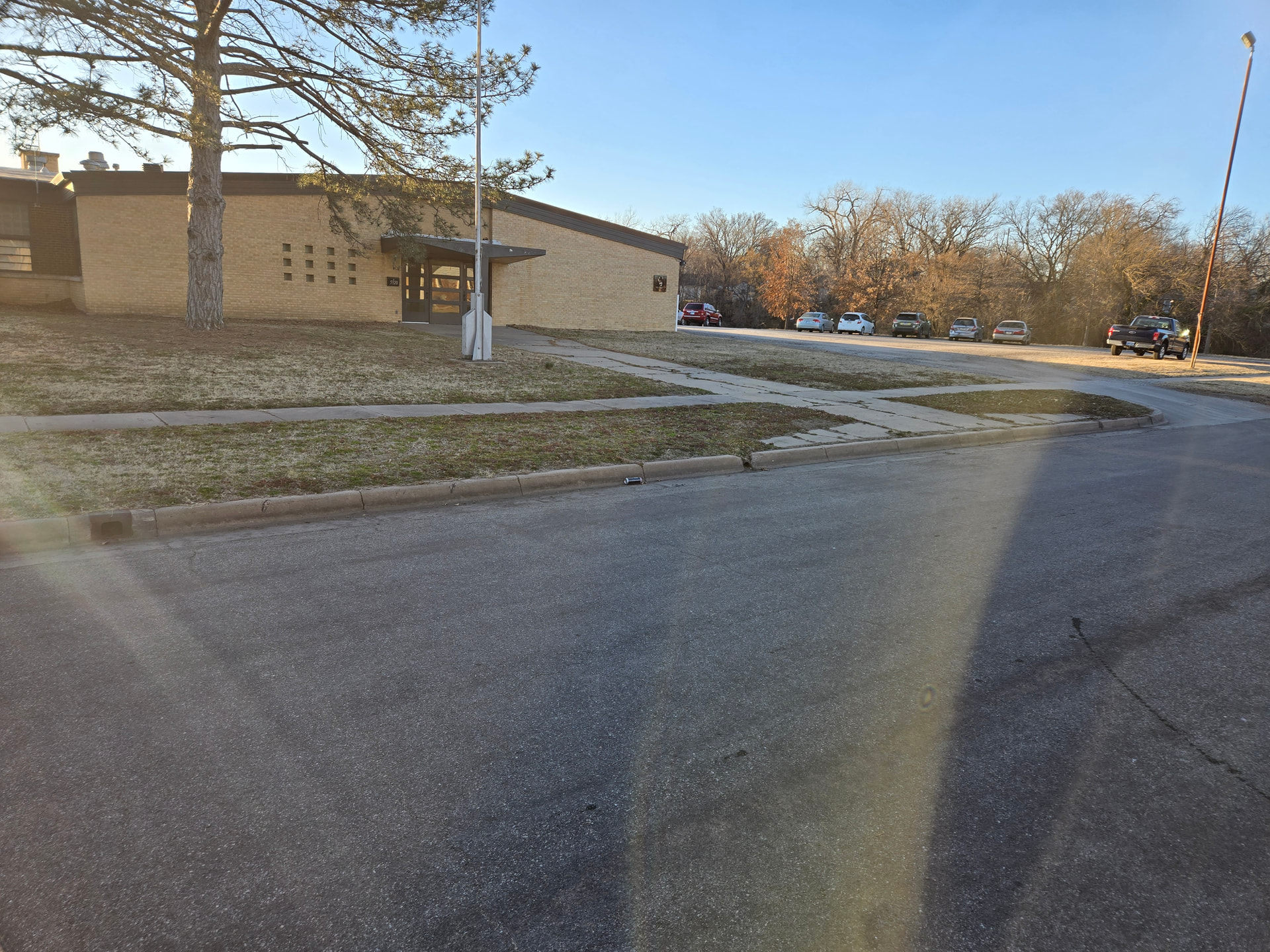

Someone mentioned it would be more handy if there was handicap parking by south doors.
So AI back at it…
The before image:
The after image (kinda surprised that the AI zoomed in on the edge of the building)
That actually looks like a good idea.

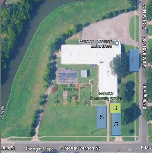

Parking off the south end is definitely going to be more expensive in regards to the amount of concrete needed.
The blue blocks are all the same size and represent a 25ft x 60ft area of concrete thick enough to park a vehicle on. Green is a 30ft x 25ft area.

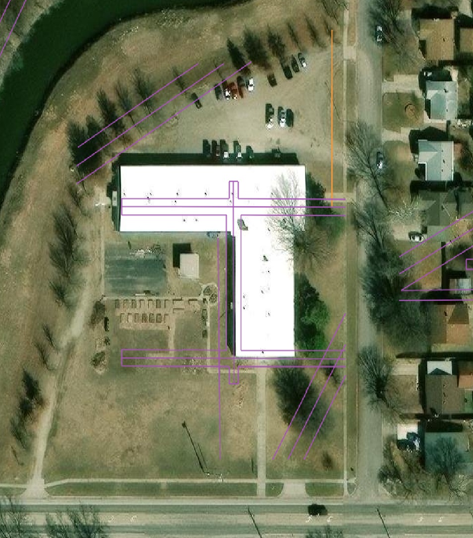

I’m a bit surprised to see that there is an easement (orange) near the east entrance, and a bunch of setbacks (purple) near the south entrance. We’d have to check with the city if that means that we cannot put parking in those areas.
Link to Sedgewick County easements and setbacks: ArcGIS
I understand, my thinking though is pointed towards phasing in a full parking lot, yes, we can build accessible spaces there but we should do it as an initial step in a larger plan if we’re going to put them along Mt. Vernon since we have a large open space there with two curb cuts, it changes the project possibilities. The location along Drollinger is more finite in its scope as it pretty much uses all the available space. I think that Drollinger is ideal over the South end because we already have our entry infrastructure located there.

https://www.wichita.gov/DocumentCenter/View/21321/Instructions-For-Applying-For-An-Use-of-Easement-Permit-To-Be-Recorded-rev-12-7-2023-PDF
Link to Easement use request.
As I recall, the “setbacks” are from the old platting and would have been either alley utility easements or actual setbacks to the front of any structures built along where streets were laid out. The orange easement might actually be extra street right of way in case a vehicular bridge was to be built where the pedestrian bridge crosses Gypsum creek. The two diagonal easements are drainage easements, one in the northwest part of the property for the creek and embankment and one in the southeast is part of a long, 60 foot wide drainage easement that may have been set aside for running a portion of Gypsum creek in buried conduit(s).
In any case setting up a meeting, possibly by phone, with the city planning department would be advised.
That document is typically for very different purposes than what we are contemplating. A typical minor street privilege permit would be for outdoor seating in front of a restaurant within the street right of way, or to surface a buried roof drain at the curb or an elevated walkway over a street or a tunnel under a street.
