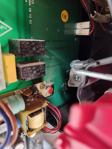

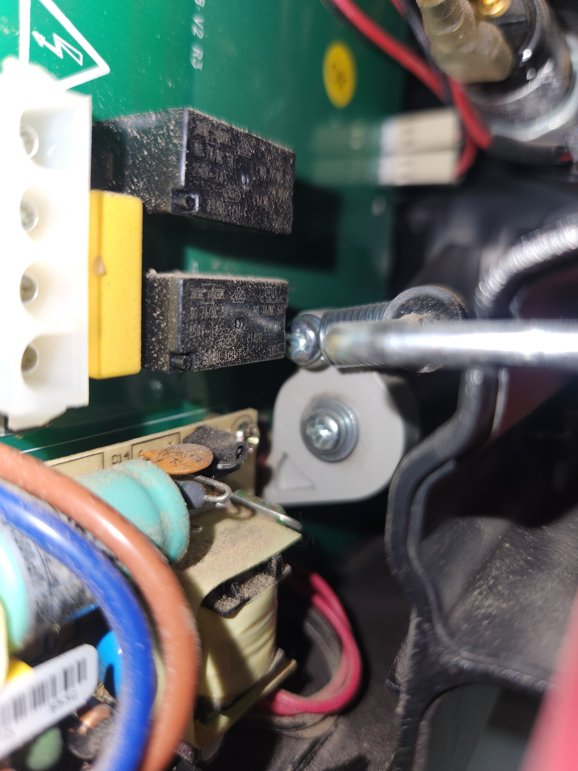

The saw stop lights green no red flash but the blade won’t spin, unsure reason.
The table saw is locked out until I can diagnose this

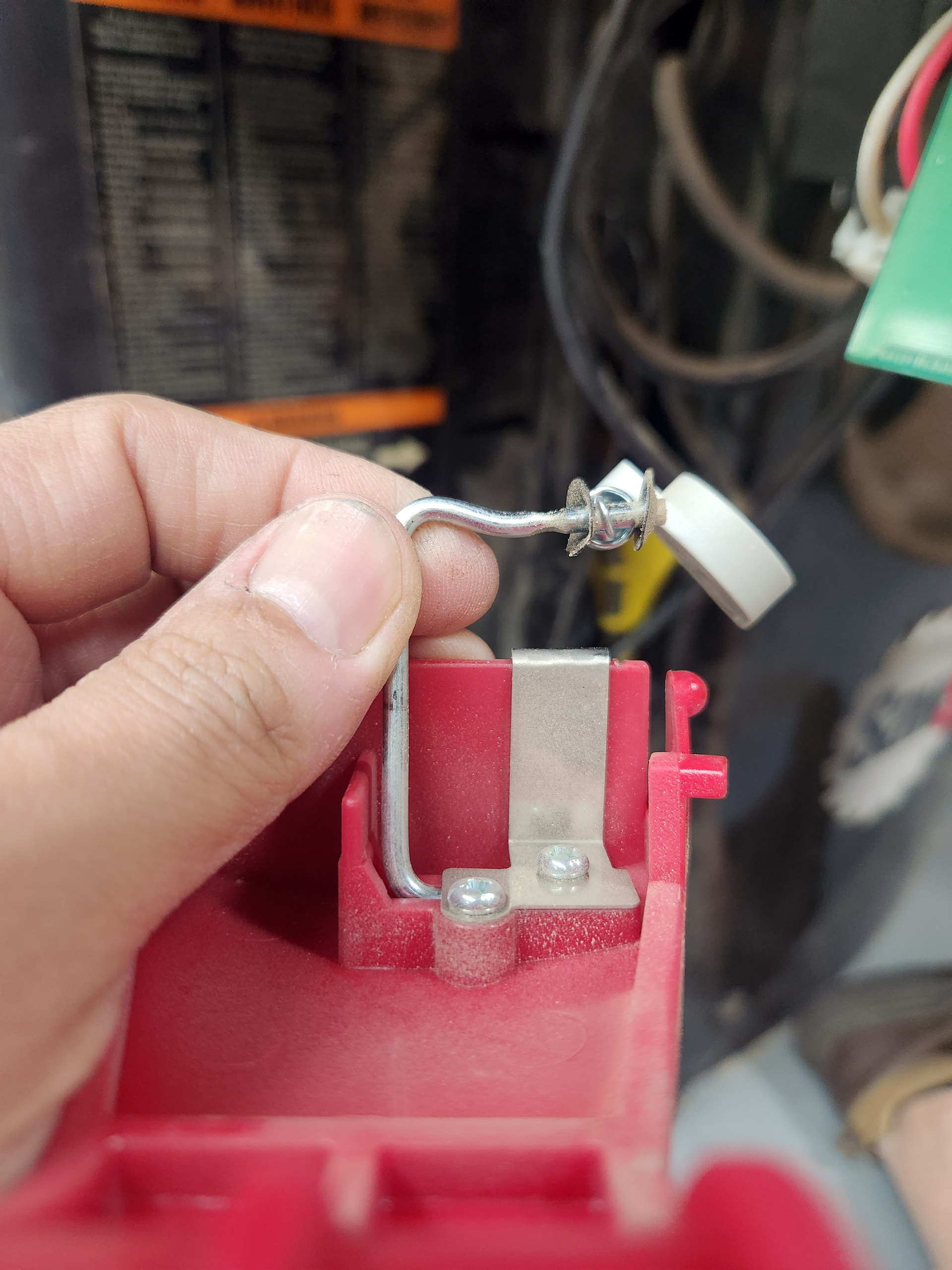

Found the linkage in the switch bent. Straightened it and all is well.
