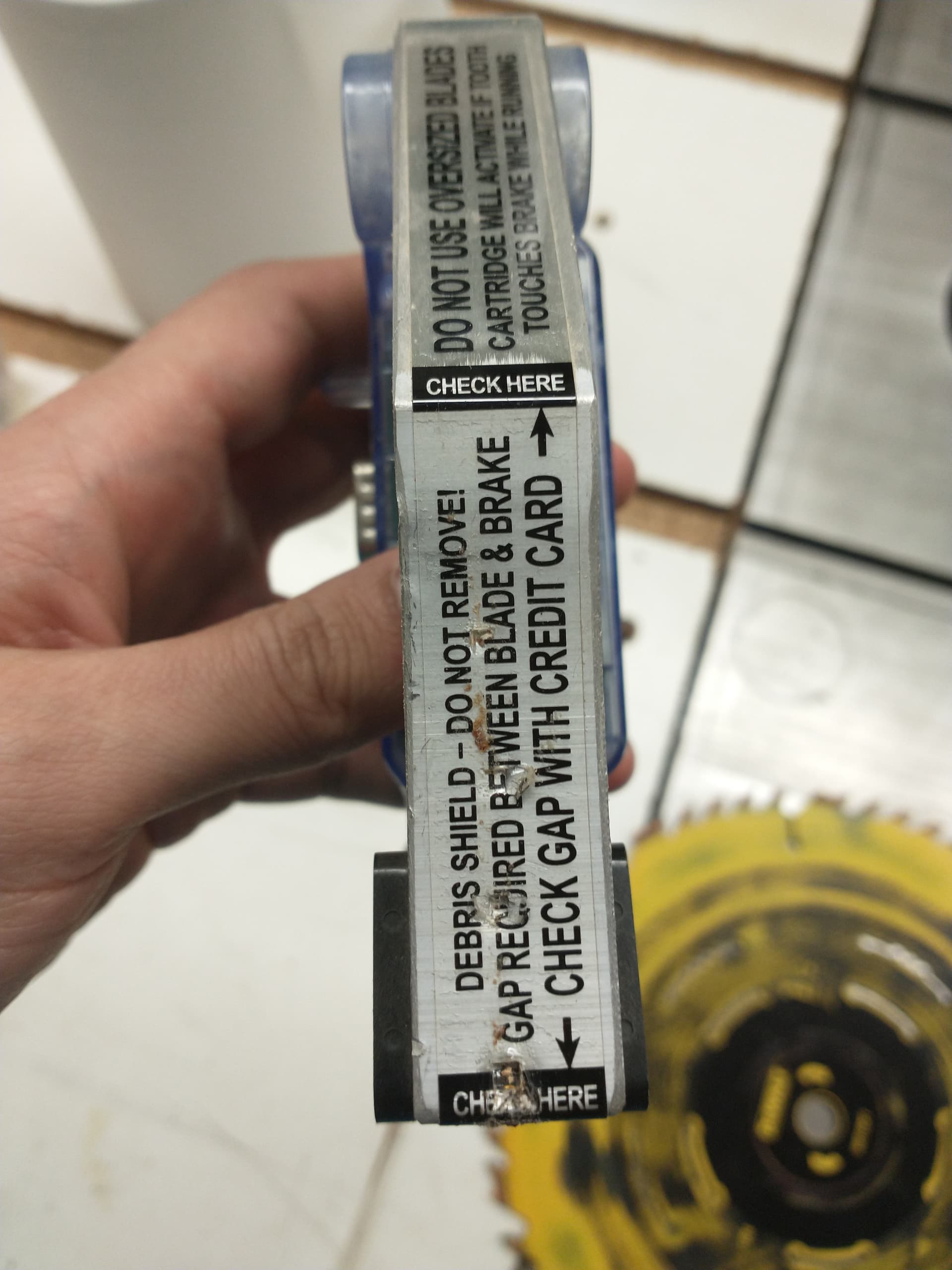

I was using the SawStop tonight and the brake fired… I can’t quite figure out why.

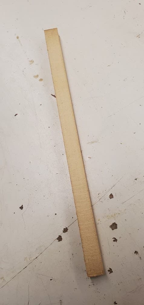

I took photos to aid in troubleshooting, but it seems to have fired after turning the saw off when I finished my first cut on a small board OR when I turned it back on to do my next cut. In either case, the blade was not spinning when it happened, the material is dry and untreated, there was no foreign matter in the wood. I left the final cutoff material on the upper corner of the blackboard by the door for inspection.
Another member arrived just as it happened, so together we reviewed the material, the condition of the brake cartridge, and the surrounding area.
Naturally, I’d like to avoid this happening in the future… I’m available if there are any questions I can answer.
Thanks…
Cartridge:
Material FINAL CUTOFF edge:

Thanks, yeah… I was pretty stunned when it wouldn’t start. As you can see from the cartridge brake there’s not even a scratch on the label. I wonder if it was still sensing after it stopped for some reason. Maybe measuring the blade with a metal ruler did it?! It’s my understanding that the light being off means that it is no longer sensing so I made it a habit to verify the light before adjust for my next cut.

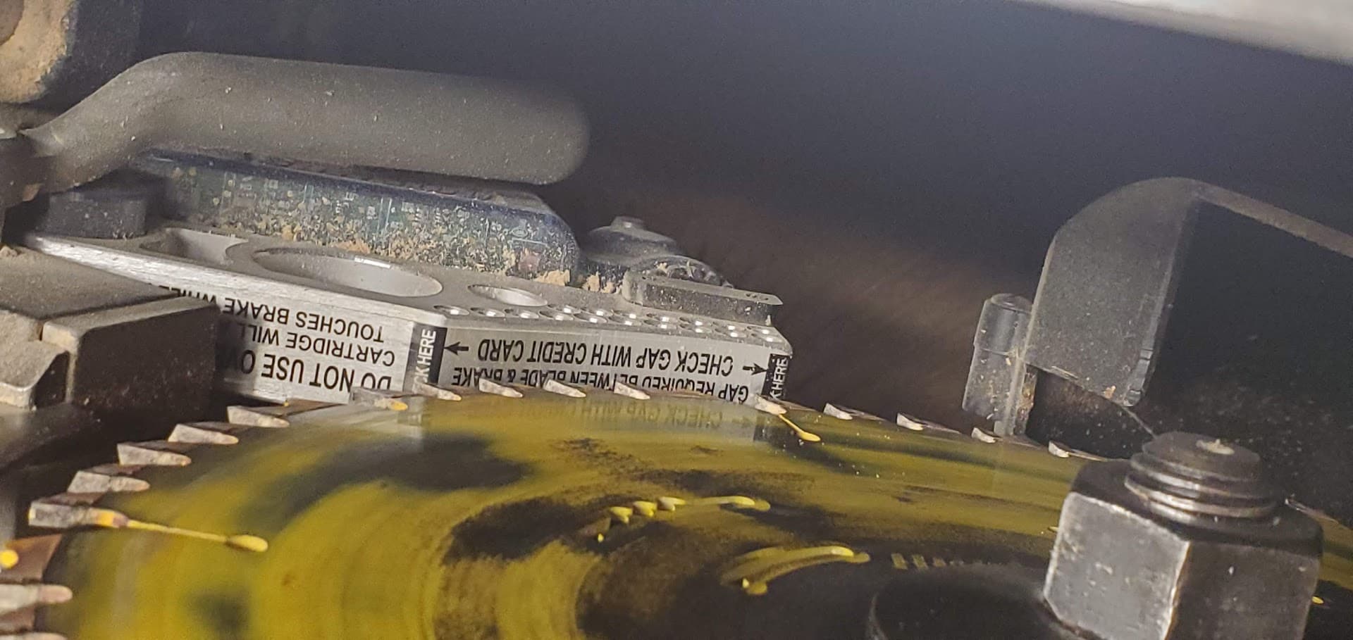

I’m not sure the brake fired. If it did, it would be I’m contact with the blade and the pic doesn’t seem to show that. What symptoms lead you to believe it was triggered? Using a metal ruler to measure the fence position is fine. I can’t think of a single woodworker who doesn’t use a metal tape measure for that.
It sure doesn’t seem to have triggered the brake to me.

Yep, definitely did fire while the blade was stationary.

Hi everyone. Just to add to the conversation. The cartridge will fire even if the the blade is only moving the smallest amount and the lights aren’t on green. Don’t ask me how I know, but I do have a tape measure with a little paint missing.
