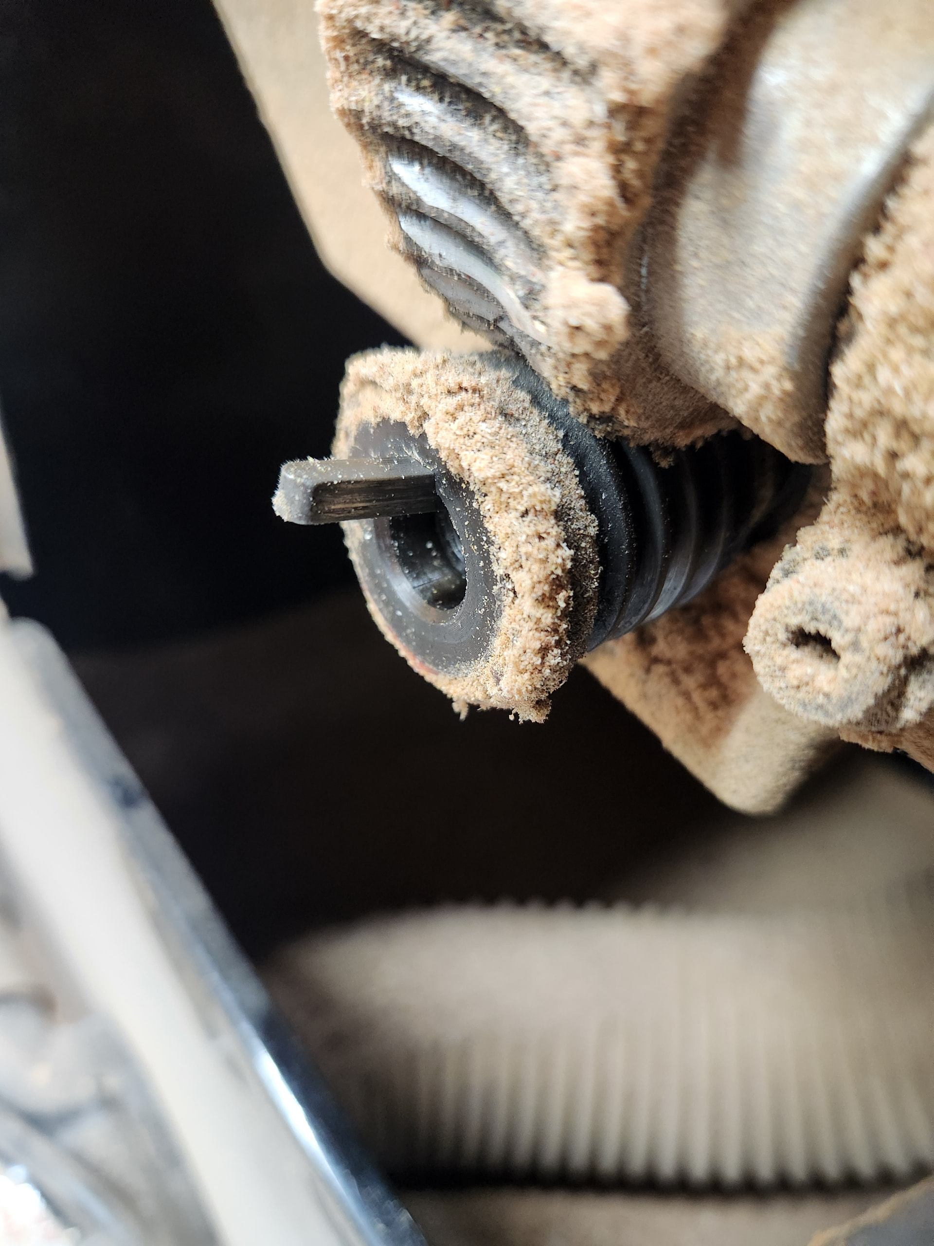

It’s been reported that the table saw has a problem with the elevation handwheel. I’ll look at this this evening.
Bolt backed out of the elevation worm gear so the key worked its was loose. Fixed now.
