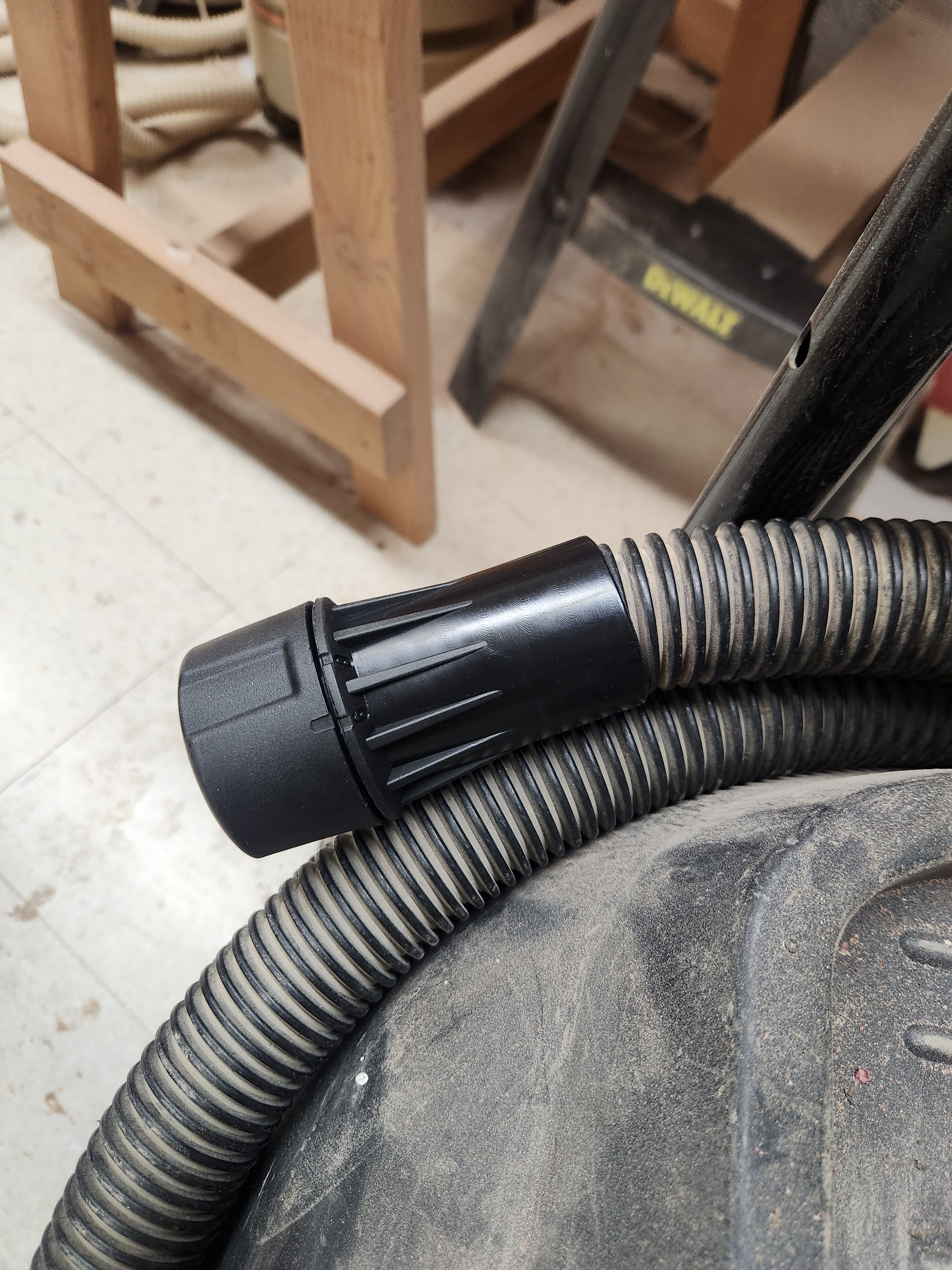

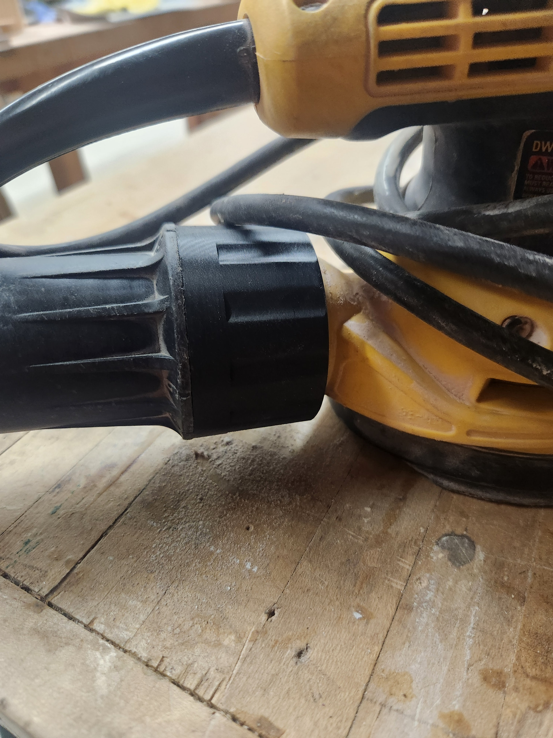

You’re talking about the big yellow DeWalt HEPA vacuumesque device that says “For Sanding Use Only” or something along those lines, right? Maybe I’m dumb or blind, but I couldn’t get it to attach securely to the DeWalt sander. Seemed to need an adapter that would securely connect the hose to the sander. The hose sort of fit and would mostly stay on while the suction was active. I was able to use it for the small amount of sanding I did but it wasn’t super convenient. Hopefully I’m just missing something.

Edit: I looked at the hose. The locking ring has gone missing. I’ll work on a remedy.
I have ordered parts to fix the hose. In the meantime, I’ve printed a collar for the hose. It’s a little tighter than planned but it does function.
The new part arrived and it’s installed. Please use the dust extractor whenever possible.
Notice the two little marks around the perimeter. Twisting the collar to align with these marks locks and unlocks the hose coupler so it can be installed.
