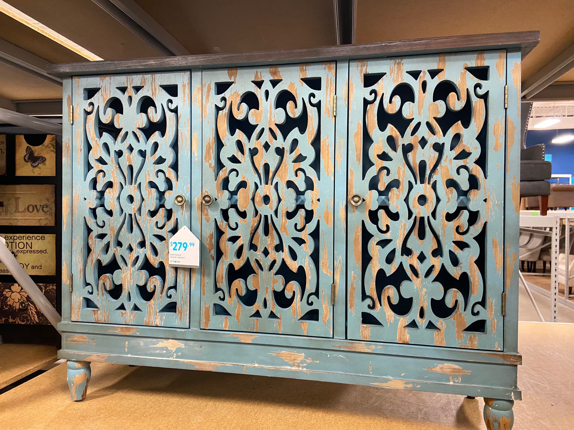

My mom is building a sun room and wants me to make a rustic red weathered sideboard for her. I really liked this one, but I would like to cut a specific design in the doors for her…maybe sunflowers? A woodland scene? A buffalo? OMG, she’d love buffalo out on the prairie! What if it could even be a continuous design across the doors?!
Anyway, getting ahead of myself here. I imagine cutting the designs— whatever they are— on the ShopBot, and wonder how thick of a wood it can handle.
Also, what would be the best wood to use? I’ll admit that I am thinking of just buying this one and replacing the doors, in which case the wood would need to be similar. So…oak, I guess?

As I said, she wants weathered red so I’d need to do the whole thing in that— basically get the same look as this turquoise, but red.
So I guess this is a question for @doug.wilson — would it be possible to cut doors like this on the Shopbot?

4x8 area. Not positive about the height. I think 10-12in. Check the woodshop wiki.
The depth of cut will depend on the end mill or router bit.
If it is flat sheet and high detail 1 to 1.5 in. It may take a while to machine it all.
There are tons of options. Depending on your end goal.
If it is a project you are putting effort and $$ into I would suggest buy new bits that are sharp.
Do some small test cuts on scrap .
Oh… I didn’t mean do it with a scroll saw… I just thought to use the scroll saw patterns with a laser cutter. (Then you already have a pattern where you don’t have to worry about something that falls out accidentally.)
Definitely possible. Find a similar pattern online, trace it in Inkscape. Then import that design into easel. I’d use a cheaper wood, though, if you’re just going to paint it. I’d recommend poplar. With those bits we keep on hand, you can cut an inch thick.
