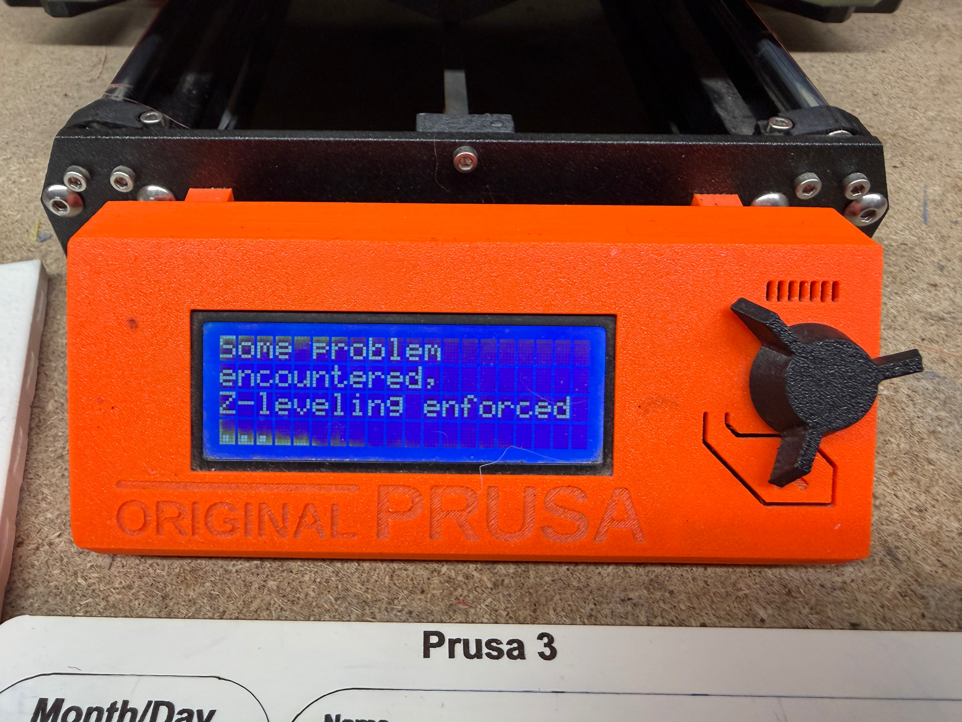

Print crashed because Z could not be determined.

I now know how to fix it but didn’t have time to look at it while I was there, as I had some place else I needed to be. Pretty easy fix but will take probably 20-30 minutes to run the routine.

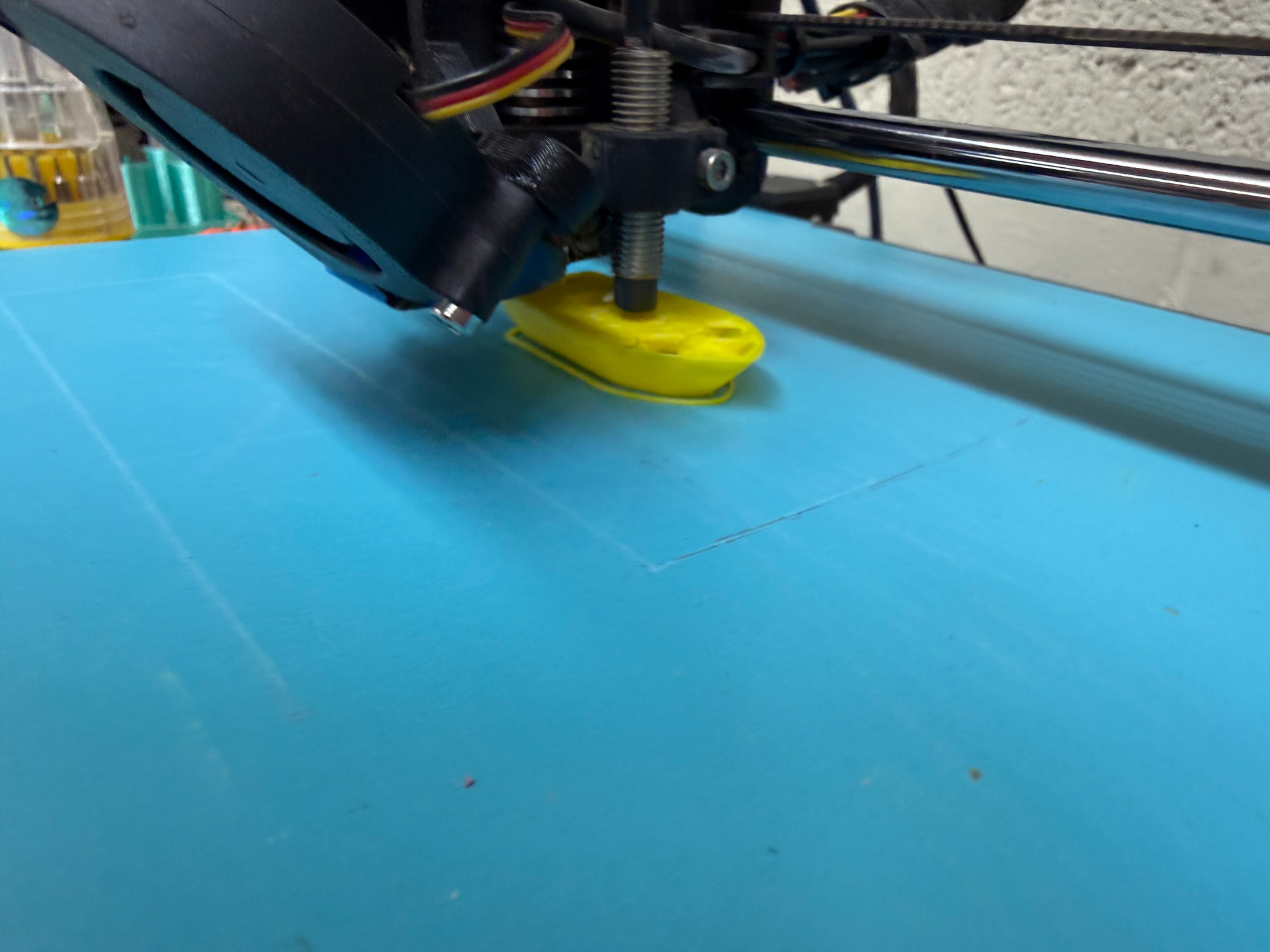

It got gummed up and the nozzle is all gunked up, so I put an out of service marker on it.

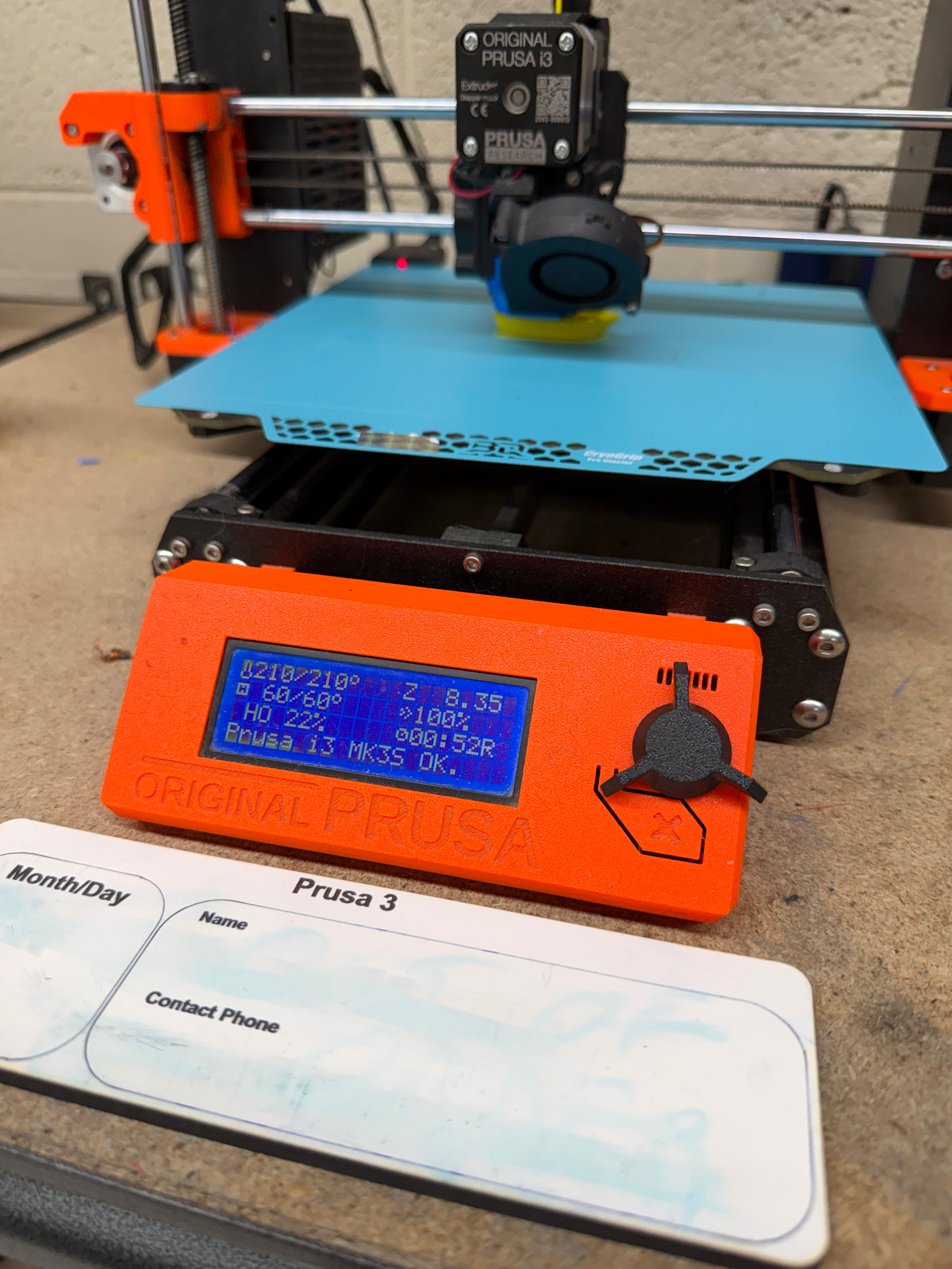

Prusa 3 is, once again, operational on 18-April. After I cleaned the blob, the nozzle was loose, which is what caused the blob in the first place.
I re-tightened the nozzle, and then re-calibrated the machine, and when I left, it was happily printing a Benchy, which the finder of the Benchy may have for their own. I’ve got far too many of my own already! lol
