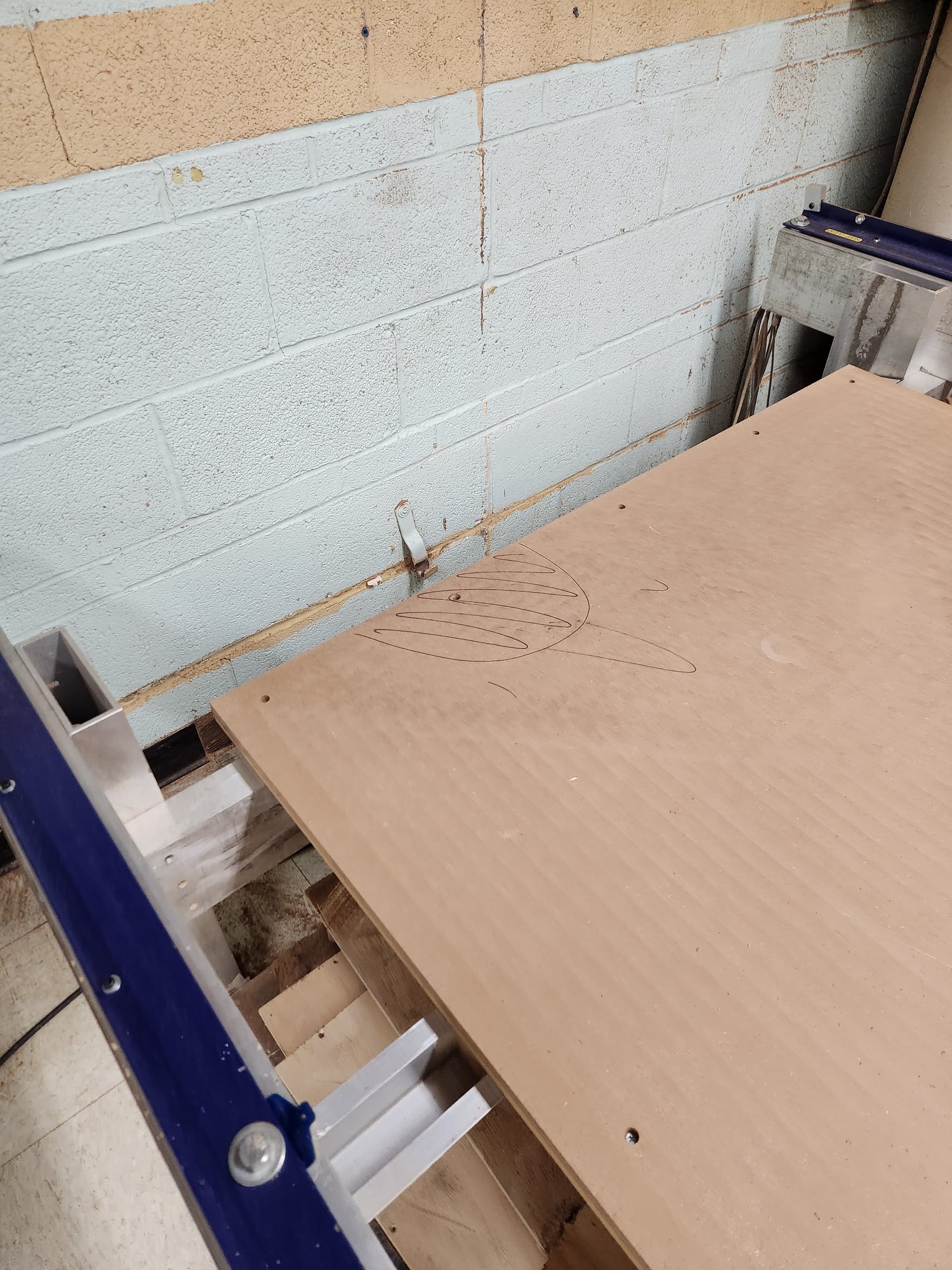

The facemill is extremely dull, as evidenced by the burn marks, but the new spoilboard is on and should be fairly flat. I will try to redo the flattening next weekend.

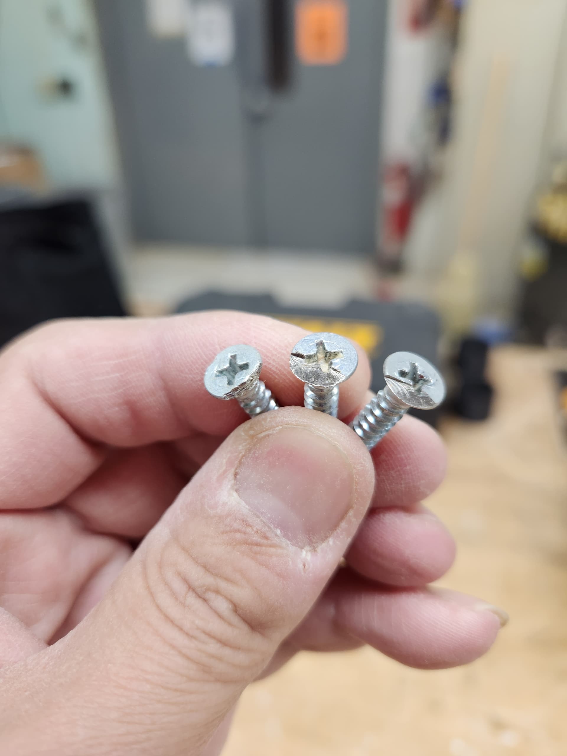

Please refrain from cutting 1/4" or more into the spoilboard as doing so shortens the life a LOT! If you are cutting into the heads of the screws holding it down, you’re cutting way too deep!
The spoilboard is flat now. There is one spot that is maybe 0.010" low at the far end, but I don’t expect it to affect very many jobs.
