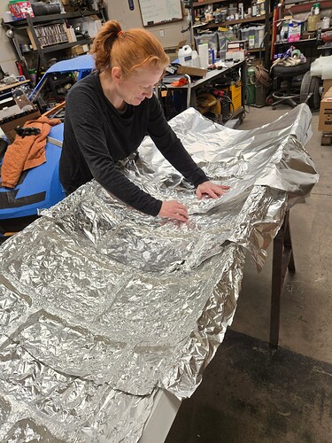

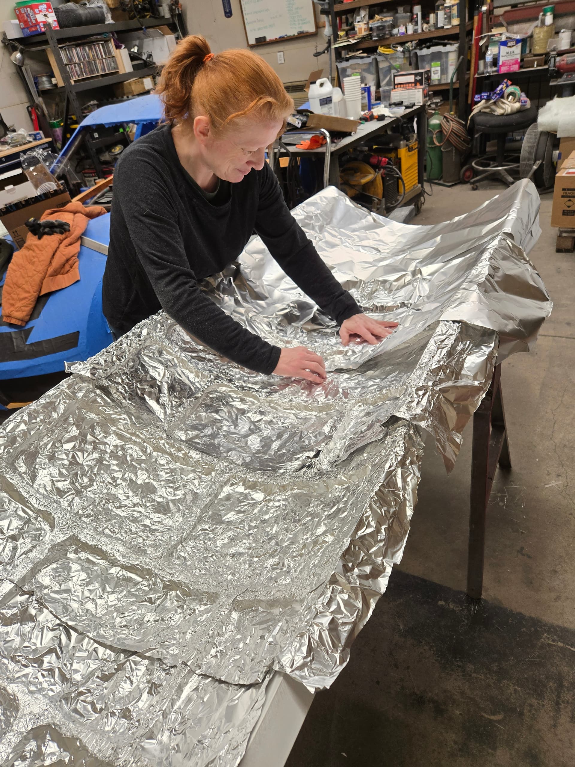

With Gretchen’s help, we were able to get the last of the 12 panels laid up for the two towers! (We managed to crank out 5 panels)

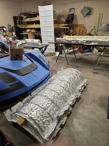

Hopefully this week i’ll be able to finish the molds for the stub walls and lay those up next Sunday. I’m hesitantly optimistic that the five panels for the center will go relatively quick, it’s turning into something we need to keep a steady pace going forward.
Also, the dump gun really sped up the process of wetting the plies. The process of laying up a panel from applying the tinfoil to being finished with cleanup now only takes right at 2hrs for one person. Though, admittedly, it is an intense two hours once the first batch of resin gets mixed. #MakerNewYearWorkout

Is that form for the walls reversible so it can do both?
