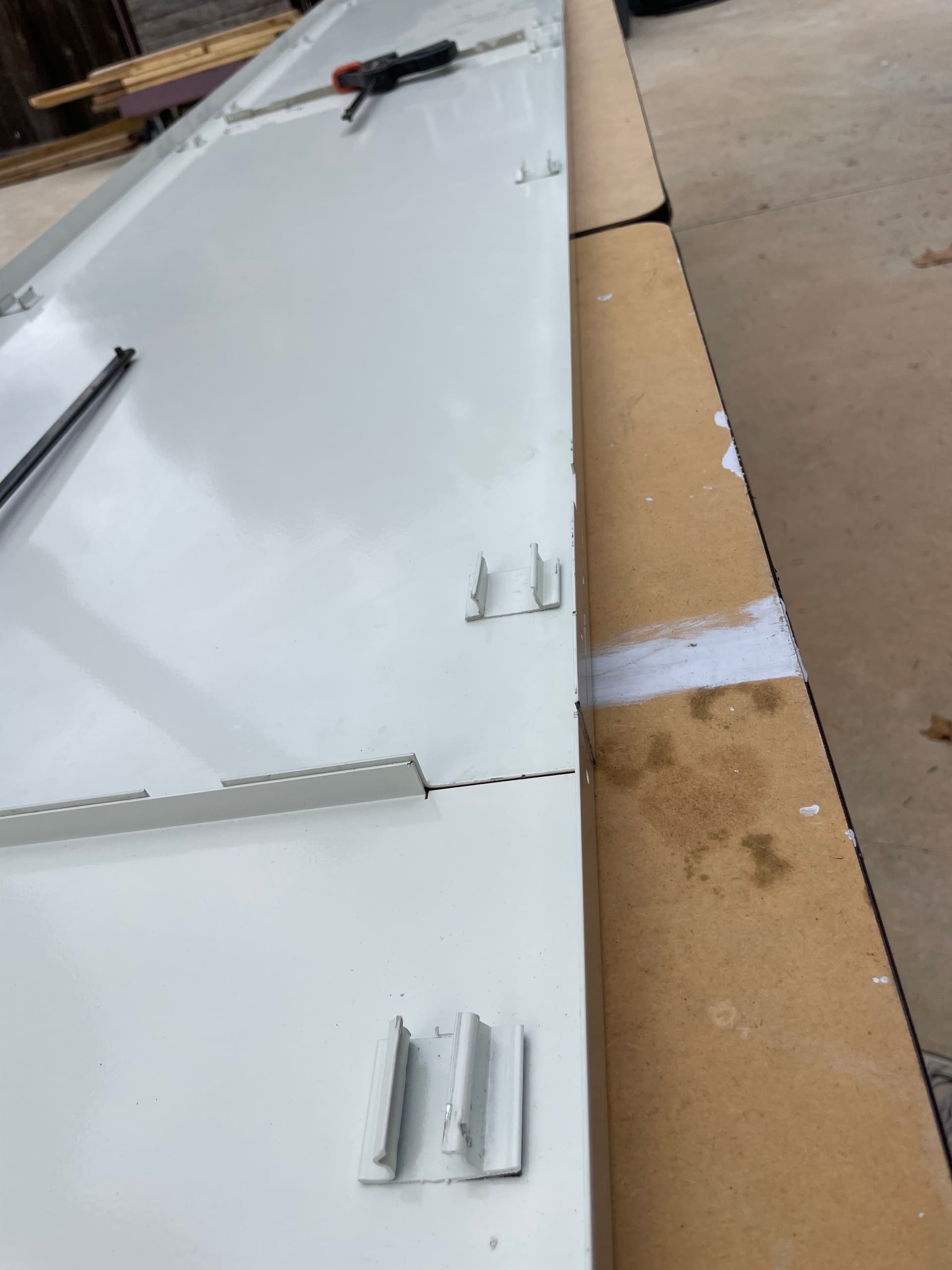

I ordered a new panel for a piece of equipment and they located the attachment clips in the wrong place. I need to remove them and reweld them in the right place with as little damage as I can get away with. I have metal shop training but I cant use the welders because I have a defibrillator. Is there anyone who can help me with this?

They’re currently spot welded on. looks like 2 spots dead center of that clip.

If the appearance is important, I would use a spot weld cutter on the clip side then rosette weld in the new location. If extra holes in the panel are ok, it might be easier to cut the spot welds on the panel side.
