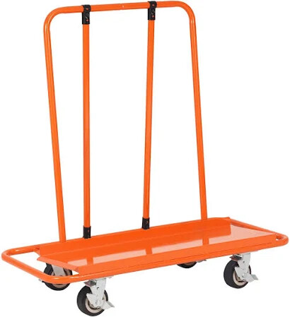

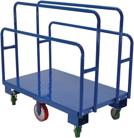

The other thing I want to do is add the ability to move sheet goods. There are a couple ways that this could be done, and I don’t know that one way is inherently better. Below are a couple different styles of panel/drywall cart that come to mind. I want to make it so that the “panel attachment” can be removed for moving bulky stuff and installed for moving sheet goods. I want this to be able to be done relatively easily by any member and without tools.

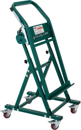

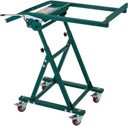

Another possible thing, though this is a little bit pie-in-the-sky and goes against my newfound philosophy of not letting perfect get in the way of good, is something that can carry the panel in, but can also flip to horizontal to allow the sheet to more easily be transferred to a pickup, for example. Something like this, but adapted to my thoughts above:
Is there a general preference among members for one style over the other?
I had hoped to get one like the top one as a donation from Lowe’s. I really disliked move sheet goods when Terrance got sheet goods from his work.
I would like to avoid getting another cart that has to be stowed somewhere. If we had one like that, we could adapt the rack portion though
