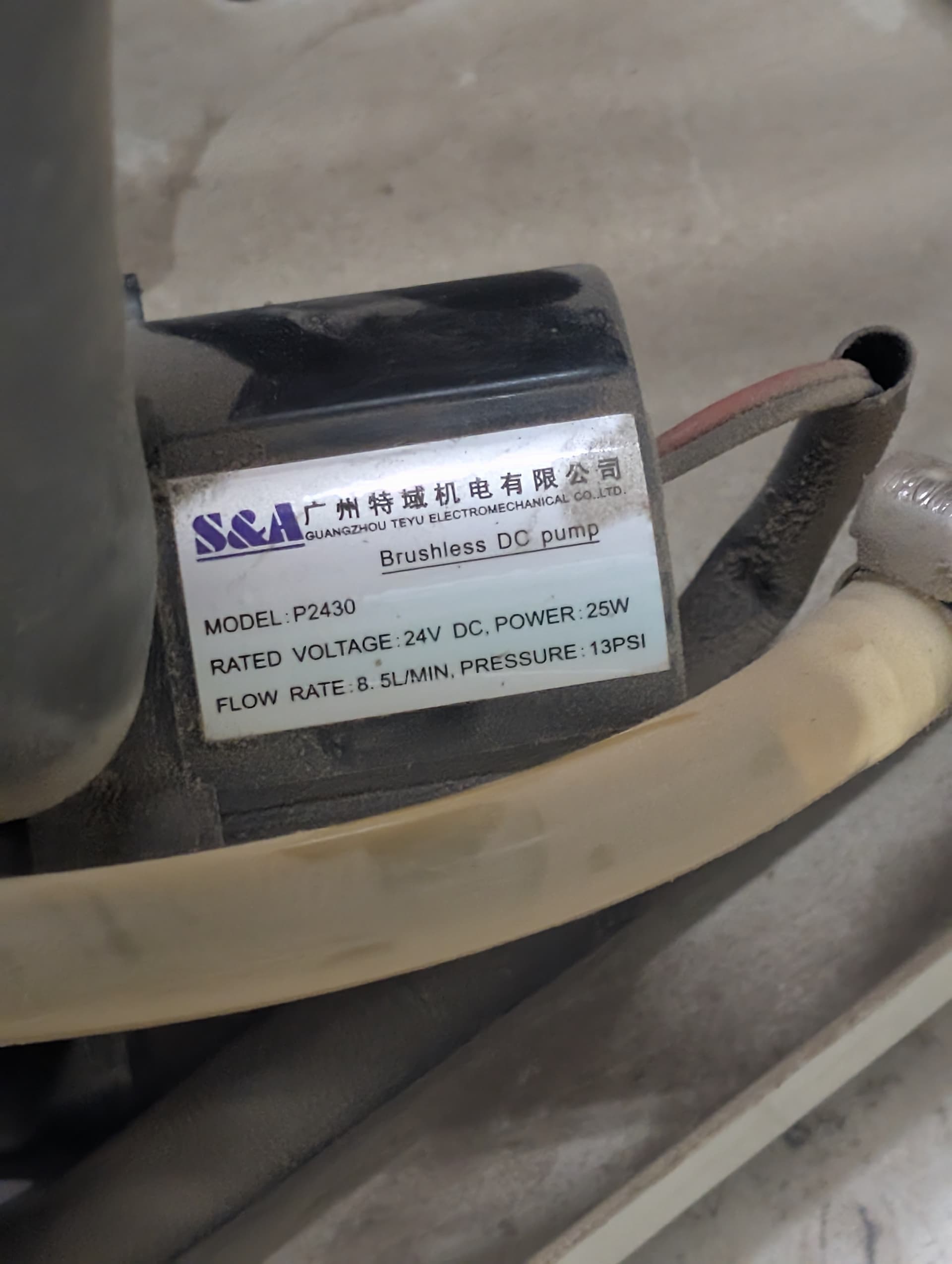

The issue which as guessed at by multiple people was the pump was not working.
Checked everything else first, Voltage out, fans, compressor, and it all pointed to the pump.
Interestingly, As soon as I took touched it to clean off the label, it worked, my guess is it was jammed with something (connections all seemed good). It has been working for an hour plus with no alarms. (Other than momentary testing by punching the lines, which gets an instant alarm response, as well as the initial alarm on turning it on which goes away. (All as it should).) Wish I could claim credit for exactly what happened (as then I’d know, maybe this is simply the threat of percussive maintenance, as I just had gotten out a hammer.)
So Mario is working, but either replacing the pump or having one on standby would be good.

Here’s the label for reference. (Looks like $45 on Amazon model is p2430) @FabLab
