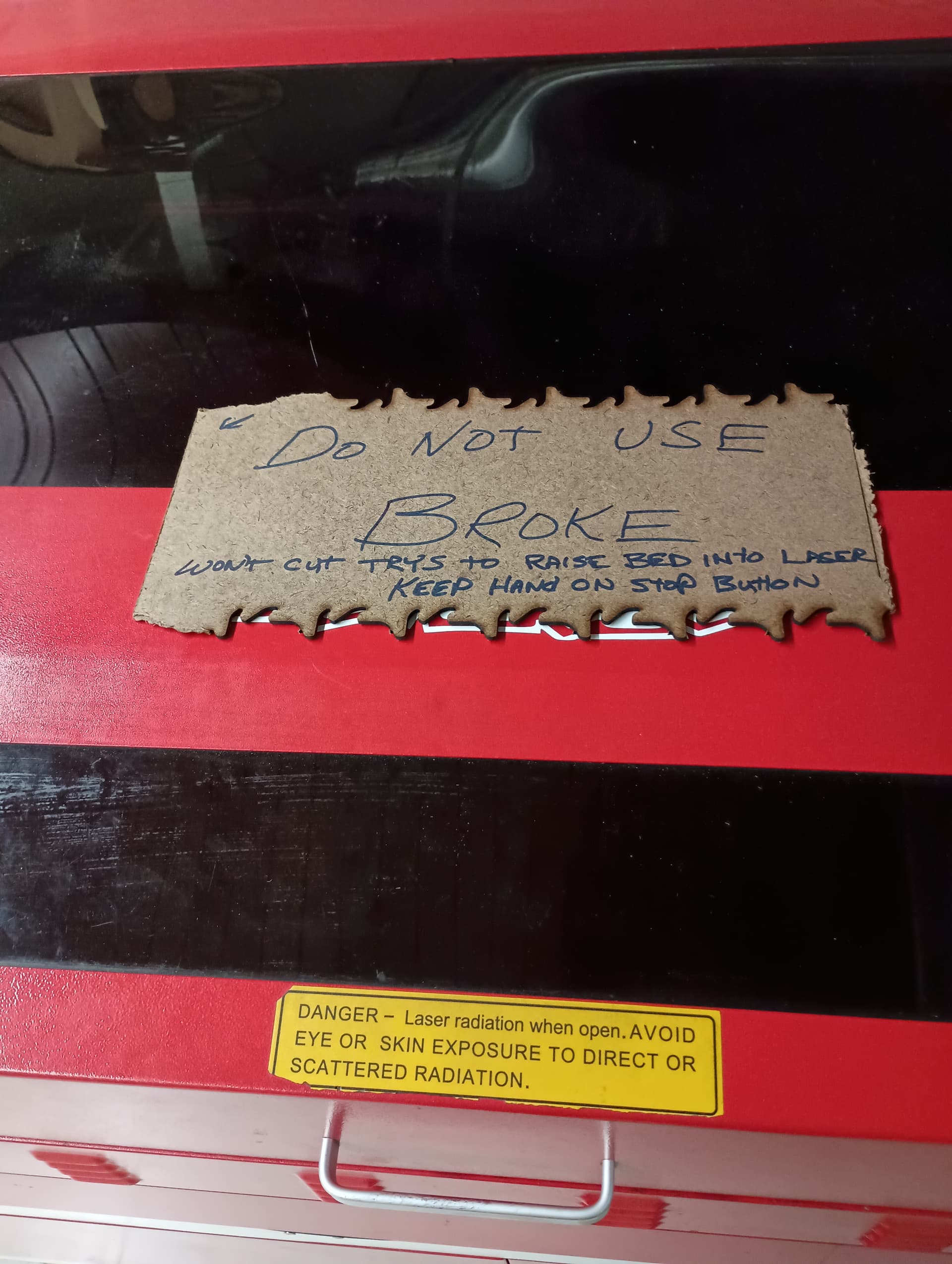

Mario down?
I know someone had this issue yesterday but I thought it was resolved.
In lightburn I went to edit>device settings and turned off the “enable z axis” setting. So far so good.
@kim
Enable Z axis! I’ve never even heard of that one - what was he status of the “enable rotary” slider?
I wonder if we also might compare lightburn versions between mario vs. luigi. allegedly someone updated mario’s lightburn - maybe it introduced this exciting new self-destruct setting?
our poor table. see, we talk about replacing it, but aren’t we all glad we didn’t.
I heard that as well. I’m guessing it came in enabled. Lovely.
Though of course, this wasn’t the bed that could use replacing.
Well, yesterday Larry came in and told me it was driving the table into the head. I said “show me” so we went and tried it - but it was fine. We cut, cycled power, moved the head, messed with settings, all kinds of things, it was working great. We couldn’t get it to repeat. I told Larry he was nuts, or at least if it was broken now it was fixed?
But after that, the sign went up - so this must be a setting that resets itself, in a bad way.
