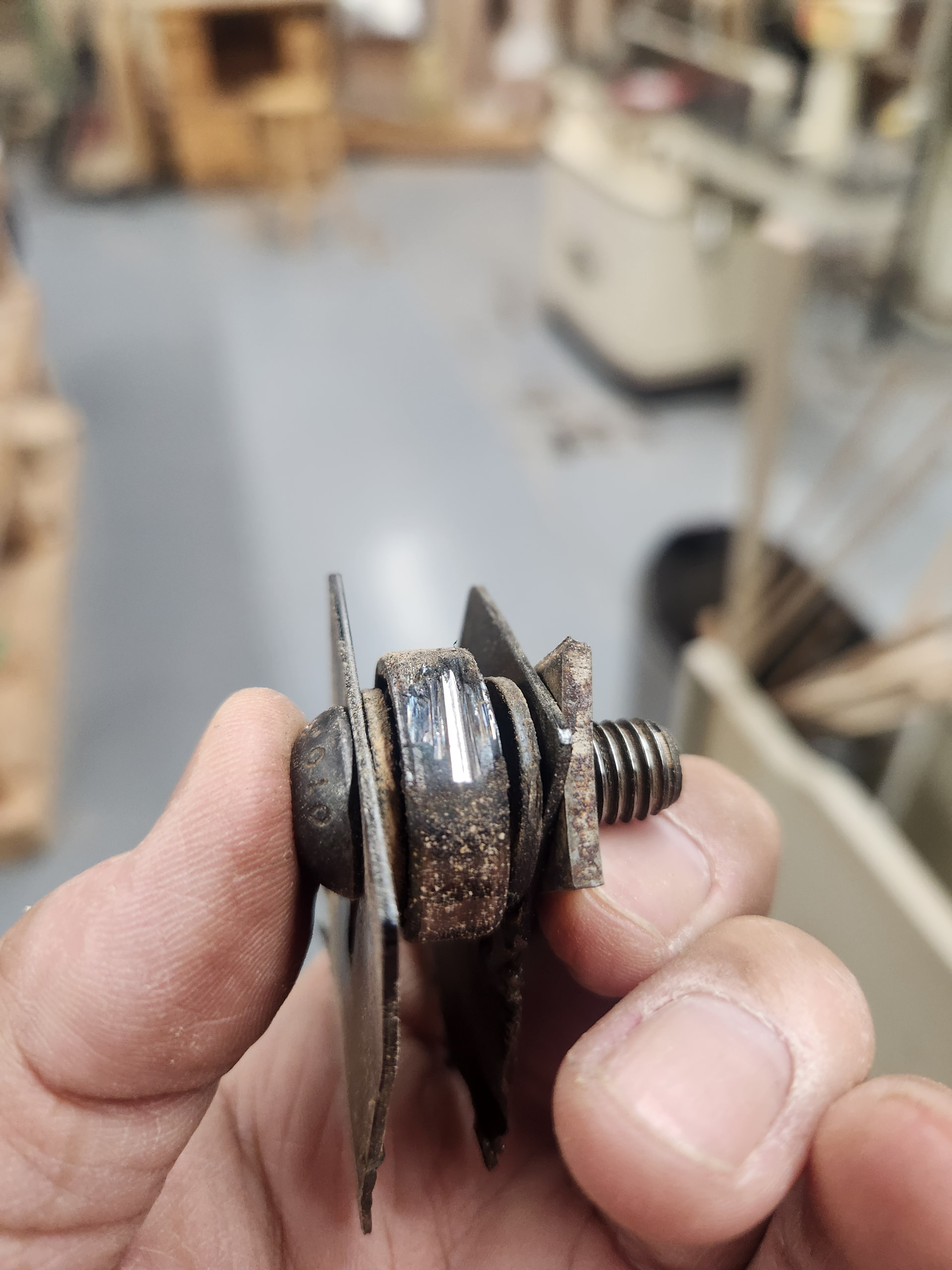

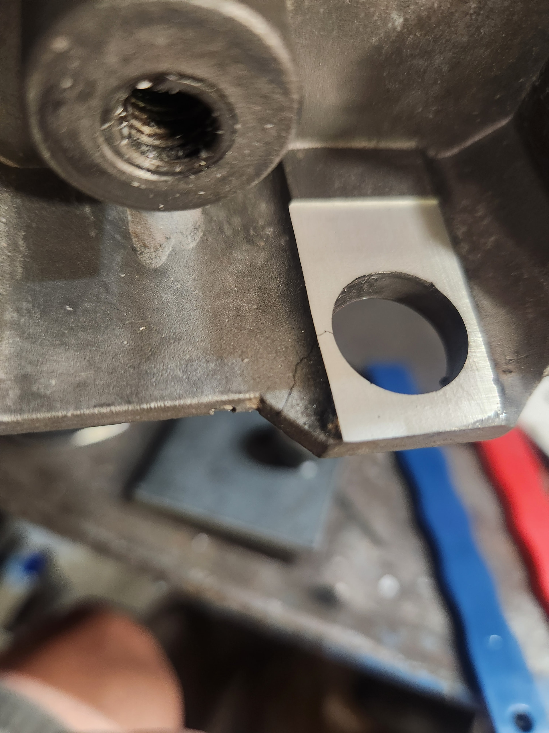

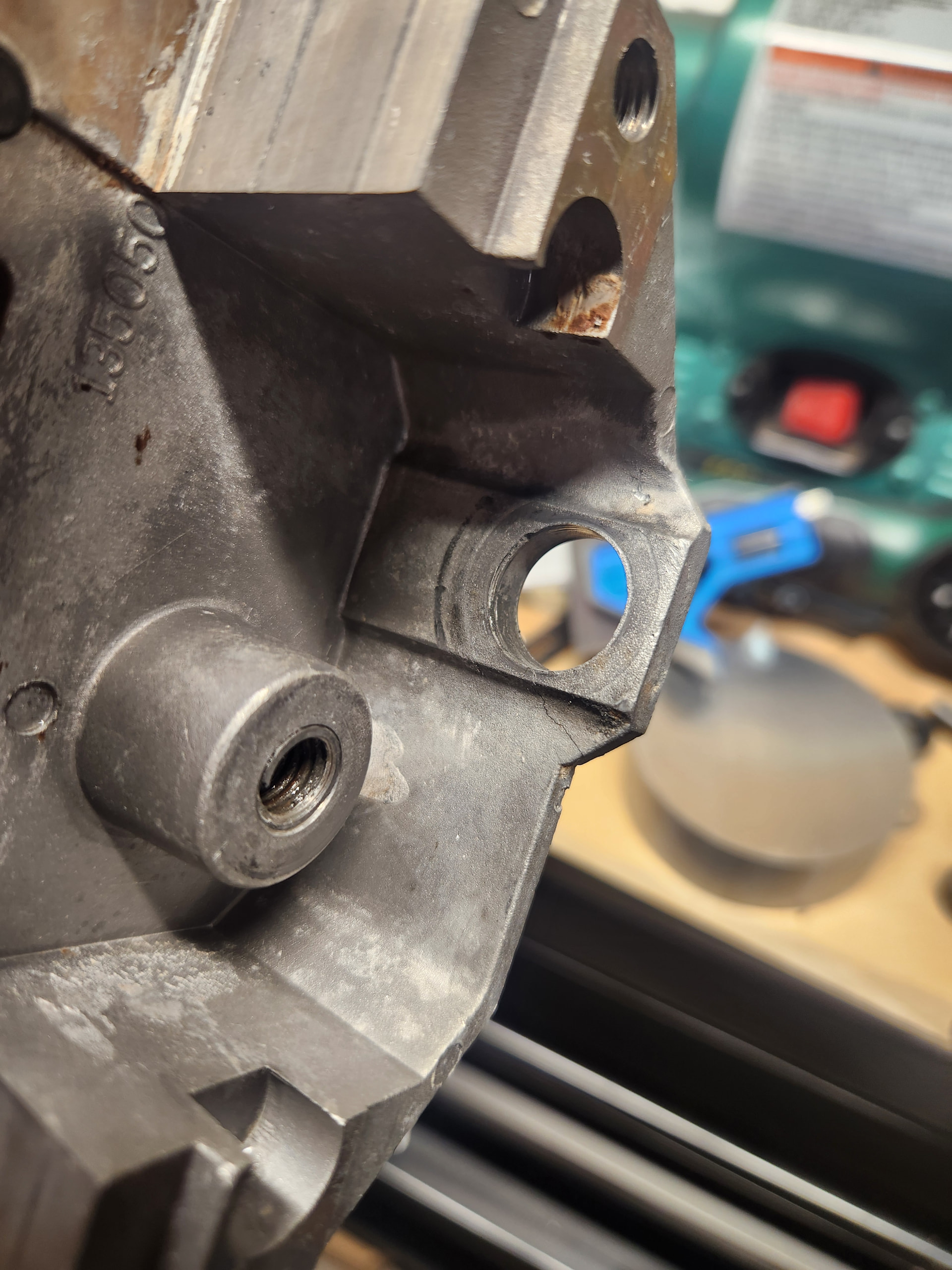

Finally finding time to install the new parts for the bandsaw and discovered the reason for the excessive wear and ultimately the failure of the gear for the upper guide. The bracket is broken which allowed the worm gear to cant, not fully engaging the worm wheel. The plan is to come to with a way to get the saw functioning again, then decide if a replacement bracket needs to be ordered. This has been an expensive month of repairs for the woodshop.

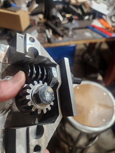

Machined opposing faces flat and perpendicular to the back then added a 1/4" steel plate to it to prevent a recurrence.
Fixed one thing… now found another. Hopefully I can get parts locally tomorrow.
All repairs are done and the saw is operational again. Sorry for the long down time.
