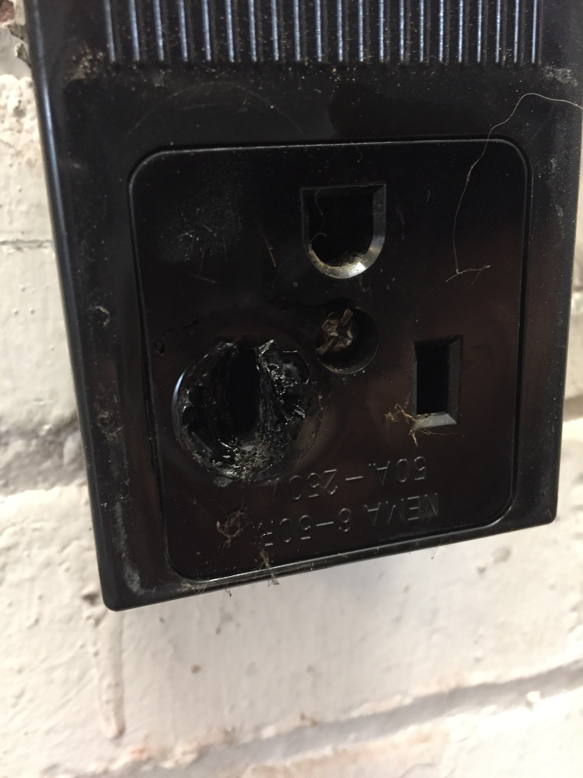

Houston, we have a problem! Last night’s glaze fire did not proceed according to plan. When I arrived to check on it a little bit ago, the controller was showing PF - Power Failure. Further examination shows melting on the plug and socket! I think the planned repair bill may be going up a bit in price.
I disconnected the cord from the socket and turned off the breaker. I placed a note over the socket and over the breaker indicating both are out of service. There was a hot plastic kind of smell when I opened the breaker box. I don’t know if this is new / related or not since I don’t routinely go sniffing the breaker box.

Thanks for that, Curt. It may very well be a localized hotspot due to poor contact. Perhaps we should consider removing the plug and wiring directly to a dedicated breaker box/cutoff switch while we have an electrician out. I would definitely be in favor of having a licensed electrician perform the work. I know that there are a lot of folks who are perfectly capable of doing the work, but if we do have a fire at some point down the line, I’d hate to have the insurance company try to deny a claim because we weren’t willing to spend the money for a repair by a licensed and insured electrician.

What about replacing both the plug and receptacle with a disconnect switch?
A new plug and receptacle of that size are both expensive and probably would need to be special ordered. Also, a disconnect is easier to operate in an emergency and can be fused for additional protection. You could also put anti-corrosion compound on the contacts easily enough to prevent a similar situation. And finally, if there was a similar failure again, it would be inside of a steel enclosure instead of in the open environment.

A disconnect is our current plan, and your donation would save us some money. The electrician is supposed to call me on Monday, 20 minutes before they head over. Is there a way you can either drop it off or we can make arrangements for me to pick it up?
I brought it to the ceramics room and put it on top of the kiln so you won’t miss it. The powder coat is a little faded, but the internal parts are sound and it is new enough to have a safety interlock that prevents you from opening the cover when the circuit is energized. It is complete with a set of 60 amp cartridge fuses already installed.
The electrician was out and got us wired up with the box that Logan kindly donated. We’re back to making things all hot and melty… inside the kiln, not outside. I don’t think there are smoke or heat detectors in the studio itself. There are outside in the metalshop.
