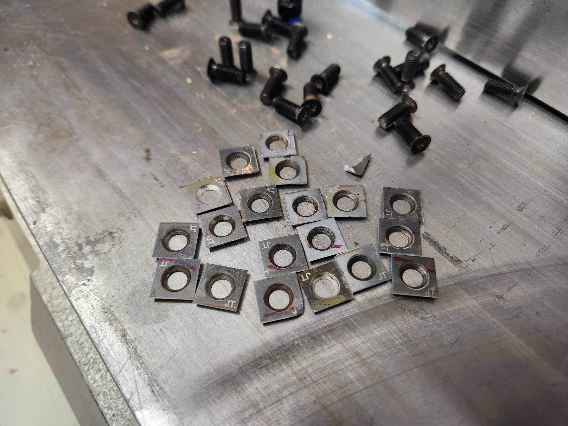

These are the chipped and broken inserts, not including the one that was completely missing and ruined another member’s workpiece because the screw backed out. And of course, the user who ran metal or rocks or chains through the jointer had to have known something was wrong but still chose not to report it or let anybody know. So, I’m sorry that somebody else’s work was damaged.

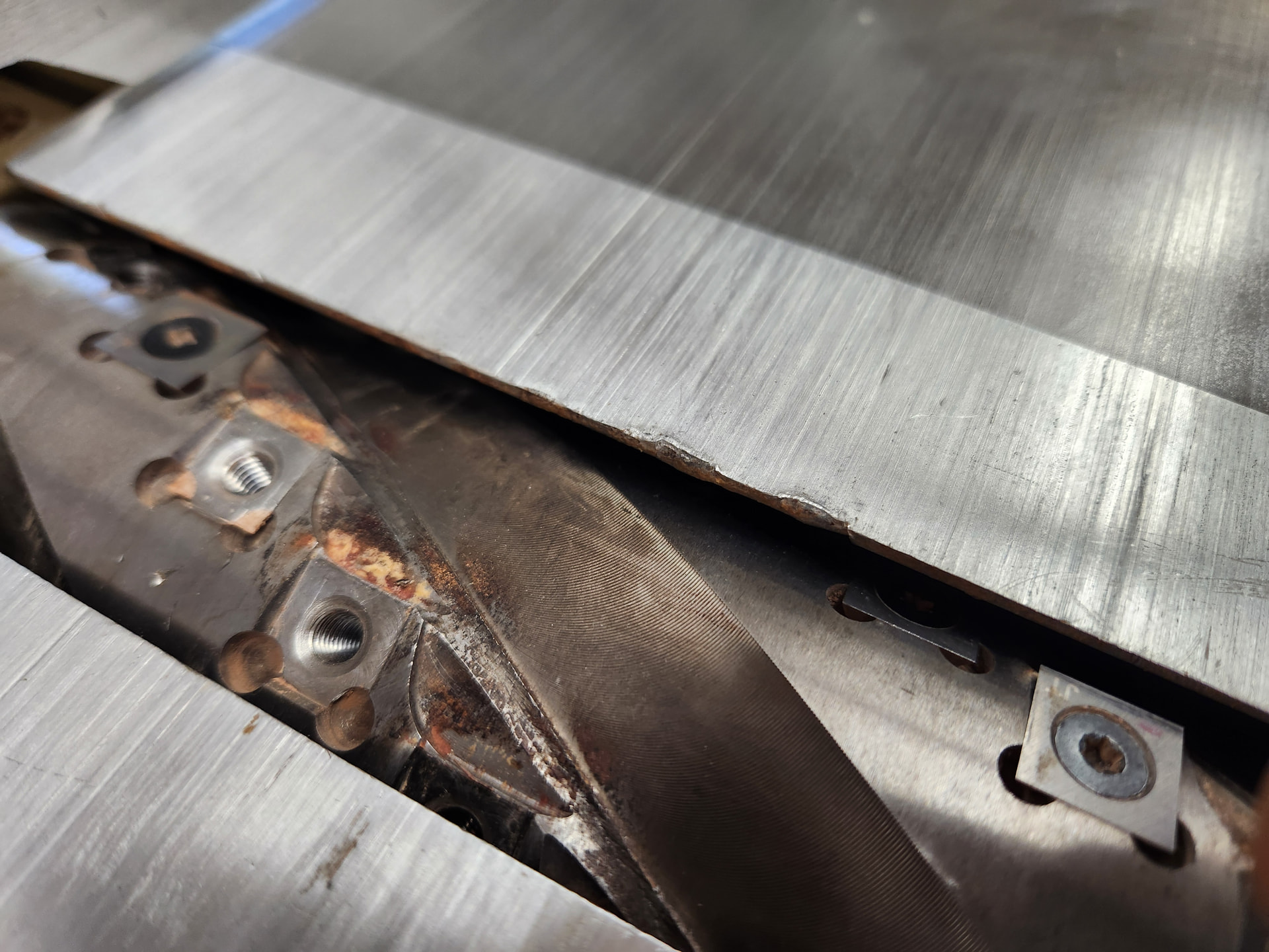

The infeed is damaged and will have to be filed down.

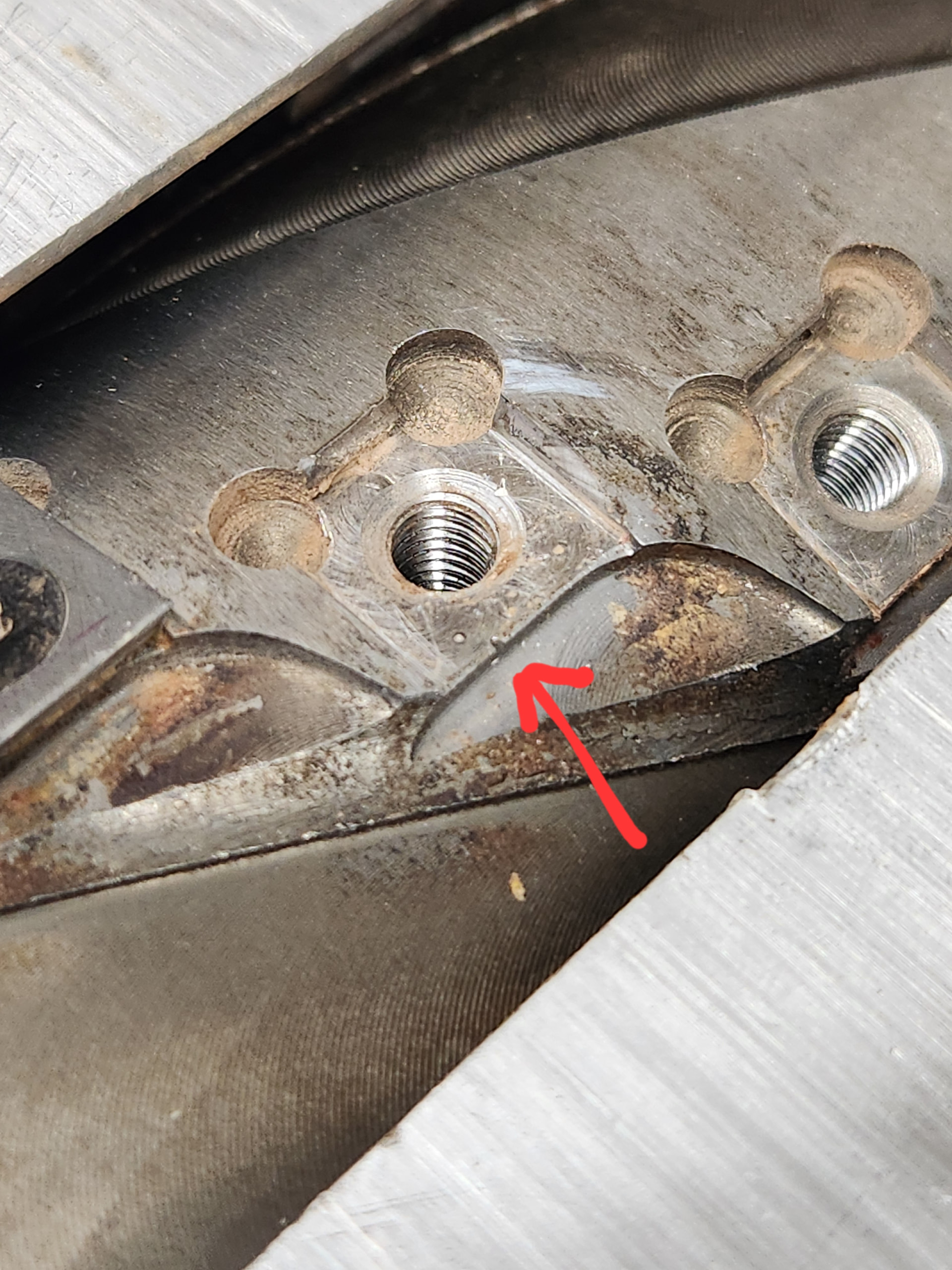

And it even damaged the cutterhead, leaving a raised spot so the carbide insert won’t sit down in the pocket correctly.
