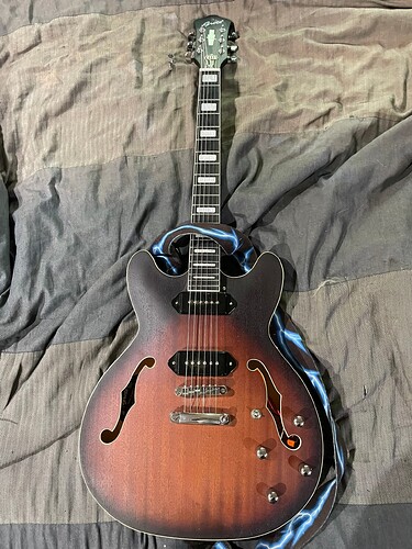

One of the cheep electric guitars stopped working. One of the pickups went silent. While the guitar is probably still under warranty, i decided to try and fix it myself. There was no obvious problem, but i had a suspicion that one of the the cheap control potentiometers was the problem.
And of course replacing potentiometers is just like installing new ones in a guitar build, with the added step of removing the old ones. To avoid future issues, i replaced all the potentiometers and all new wiring.
There were a few misteps along the way. I found out about linear taper pots and logarithmic or audio taper pots. I changed the circuit slightly to a 1950’s circuit. Supposed to be “better”, lol.
Carefully checked continuity regularly as i added components. Looked for grounding issues. When it wascomplete, i plugged it in and it made noise! Glorious overdriven noise, exactly what i hoped for.
Best, i can fix it if it fails in the future.
