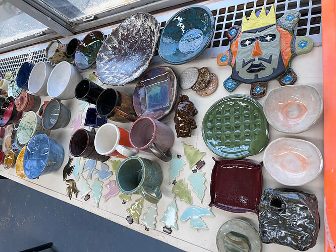

Glaze unload 12/23/25
No major issues this load.
I just picked up my pieces and wonder why I got bloating. It’s a new to me clay body, Laguna porcelain five but it’s for cone 3-5. :thinking:

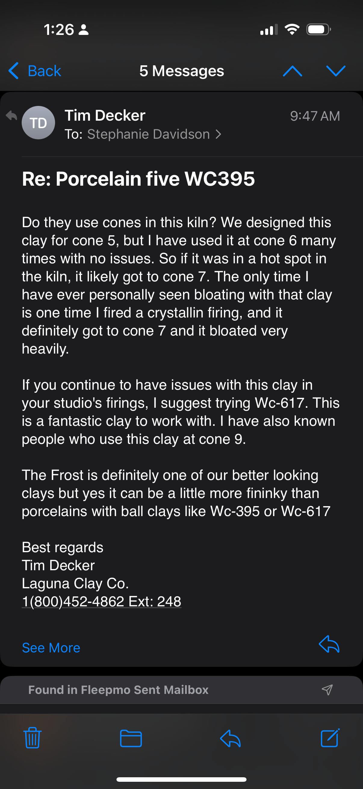

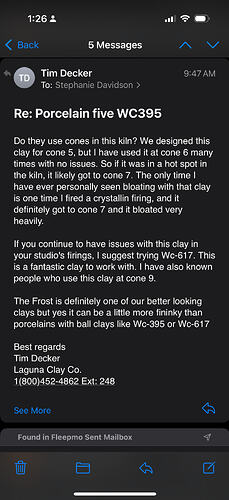

I emailed Laguna about my clay WC 395 and just heard back from them! He said they’ve never had an issue with bloating unless it got to cone 7 :thinking:
I’m so confused! I’ve made some test pieces to be fired for experimenting

Calico and speckled b-mix can be sensitive to firing above cone 5. We often fire them and don’t have issues with bloat with them.
It’s ok, I’m just confused! I don’t think I’ll be buying more of it and will likely end up switching to b mix but I do have quite a bit left. I don’t believe it would be a reaction with the glaze as I made an ornament with this glaze and clay fired at MakeICT with no issues. Maybe it was just a fluke.
