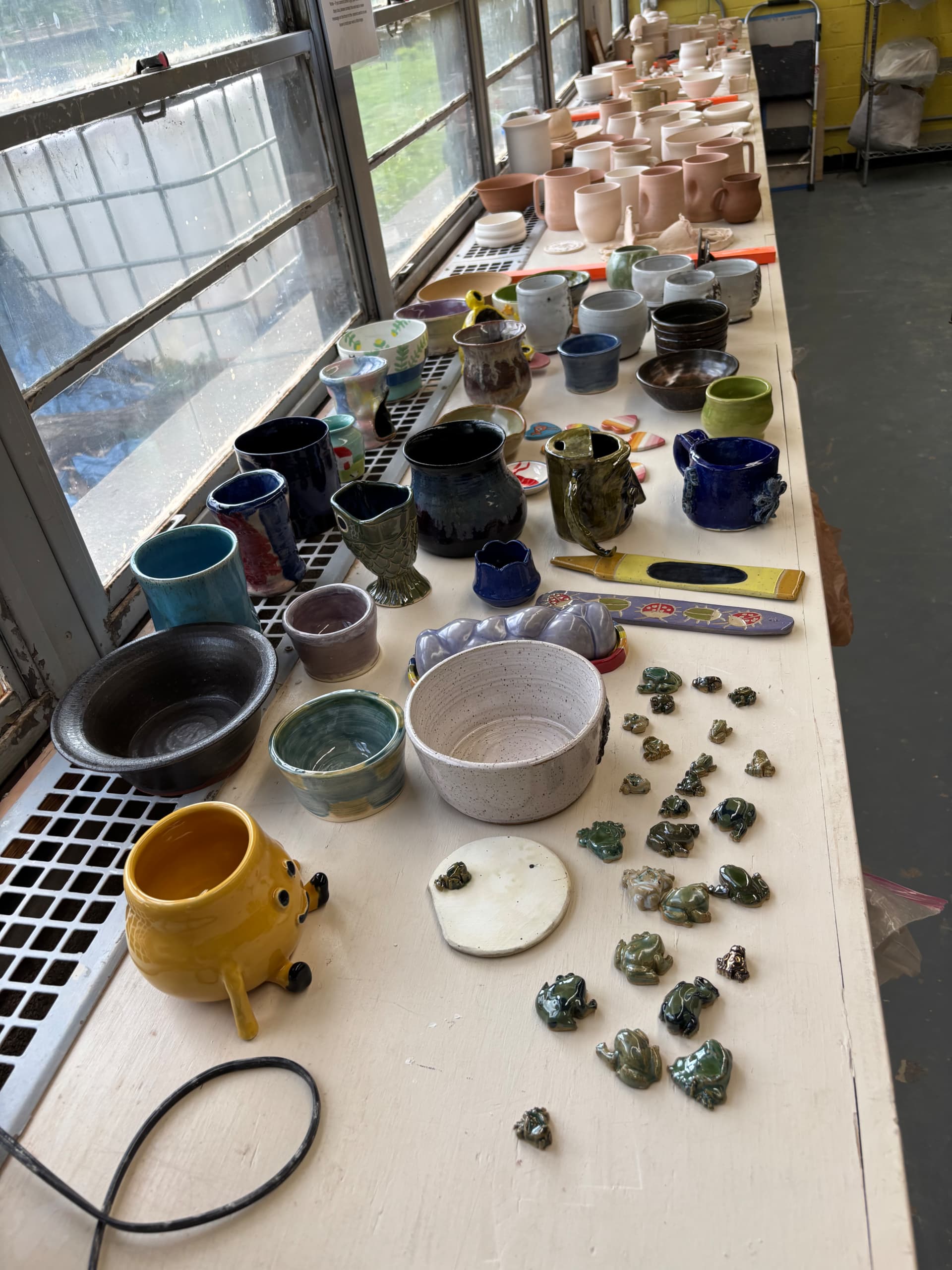

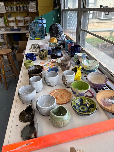

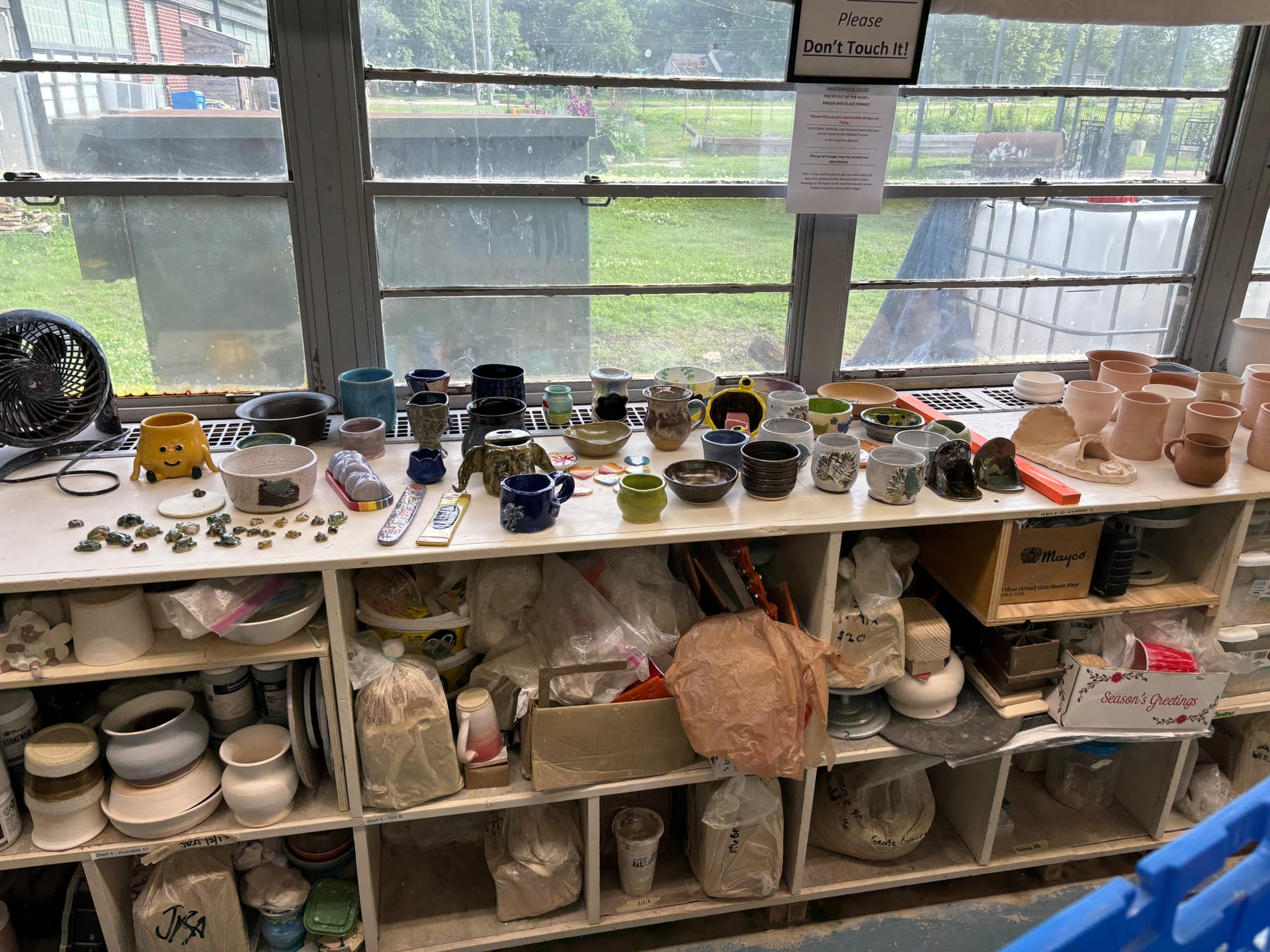

Glaze firing 6/6/25
More great stuff, no glazing issues other than the top cones didn’t quite come up to temp

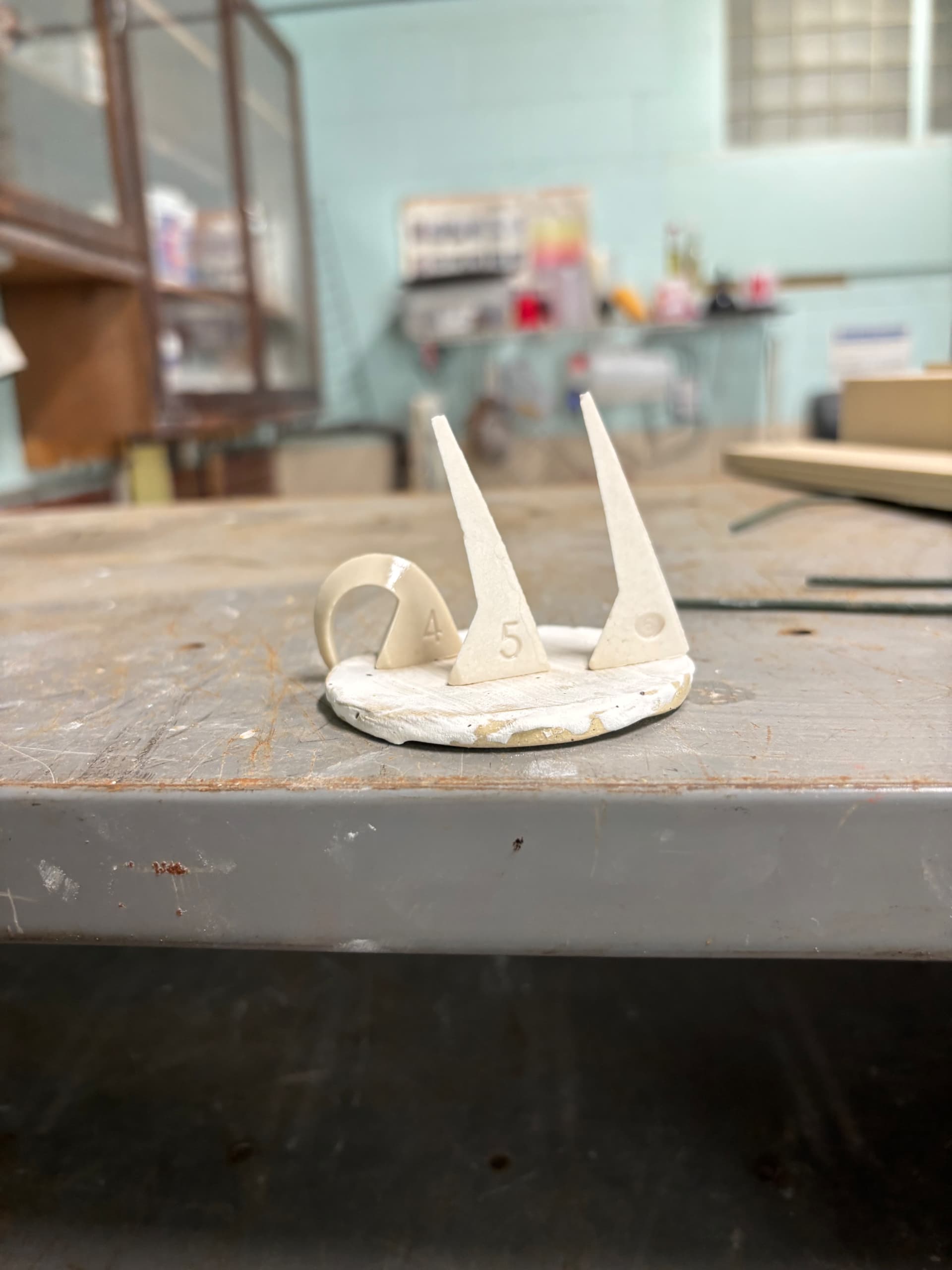

Top shelf
Maybe time for new coils, about 280 firings on these coils and firing time is getting longer.

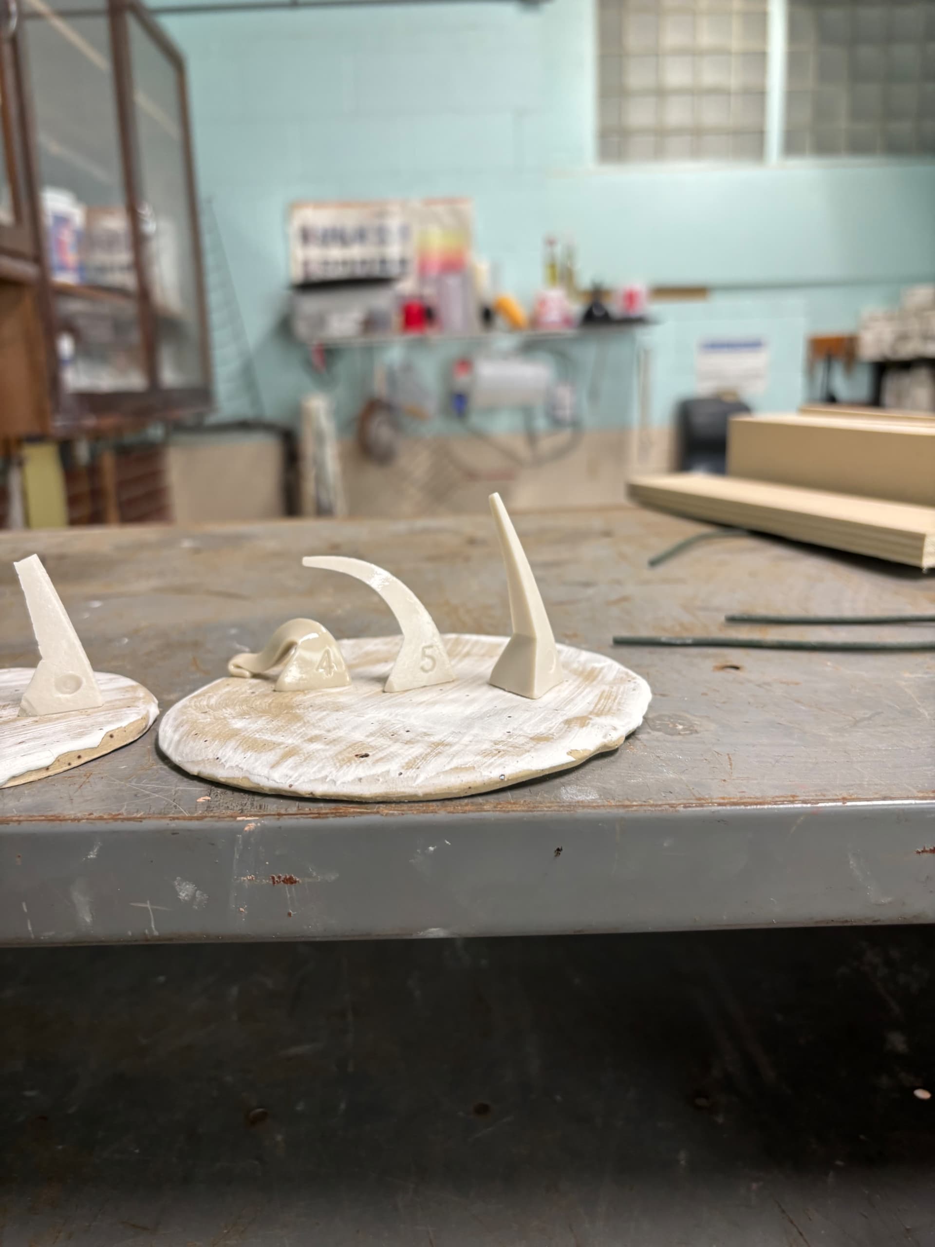

Bottom cones
