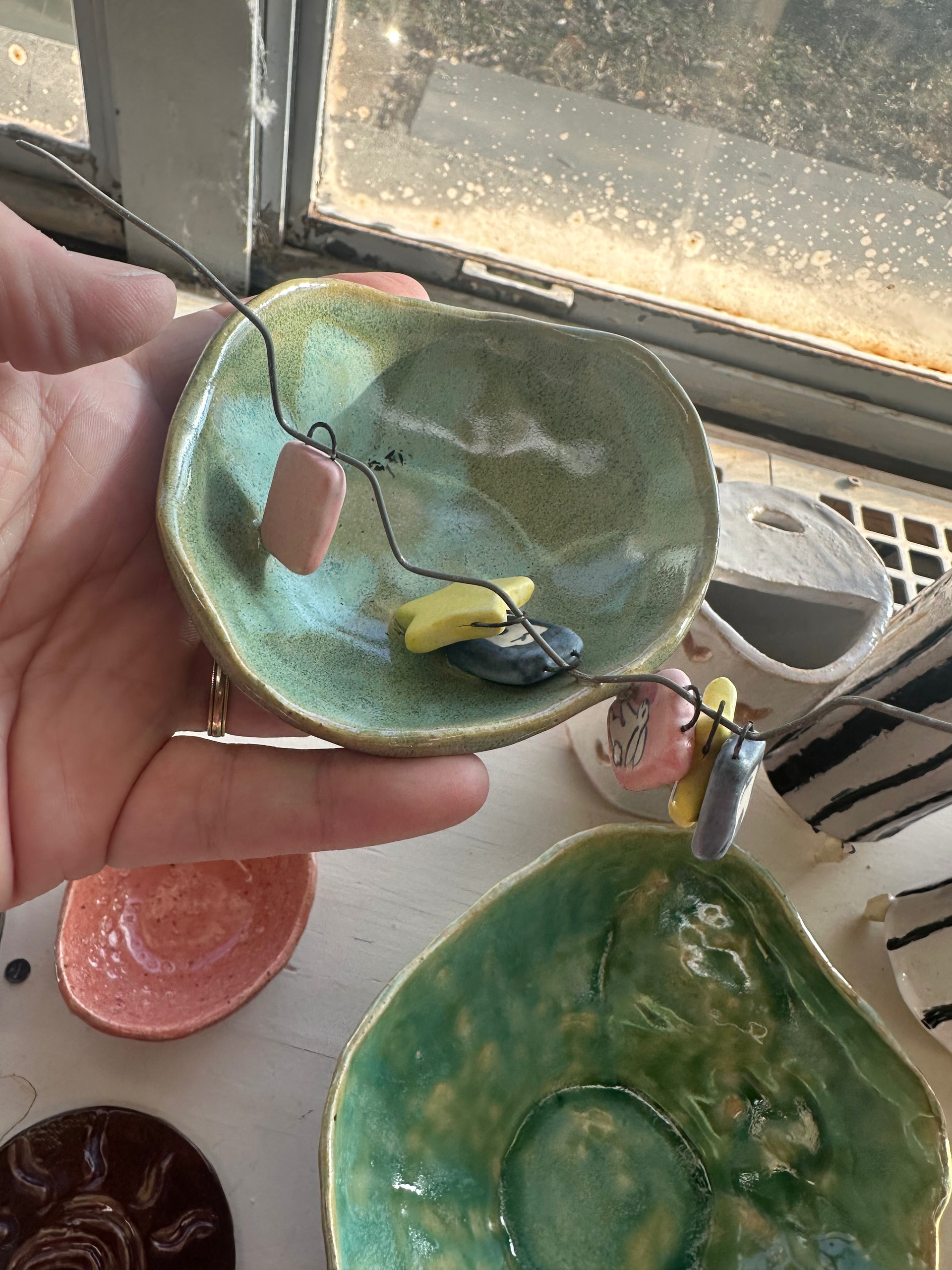

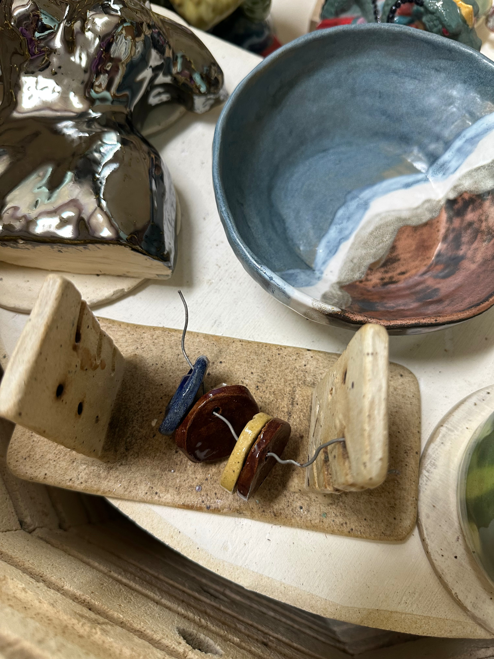

The wires used on the jewelry did not work firing at cone 5. They bowed in the heat of the kiln and let the pieces drop. Some stuck to another persons work. please don’t use that wire in our kilns.

To much weight and the gauge of wire isn’t heavy enough. I usually put a central support across any kanthol wire if there’s significant weight. Any gauge wire will droop significantly if it’s only supported by end points across the span.
