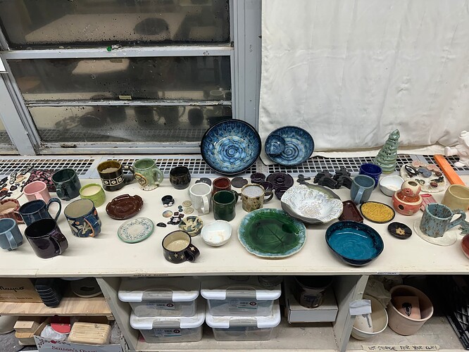

Full load- there were even a few more pieces that we, unfortunately, could not squeeze in this firing.
Many nice pieces! Good job makers!!
