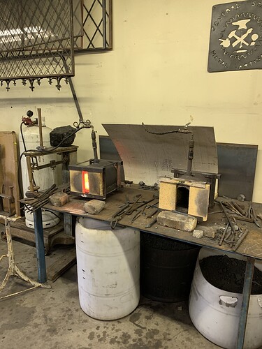

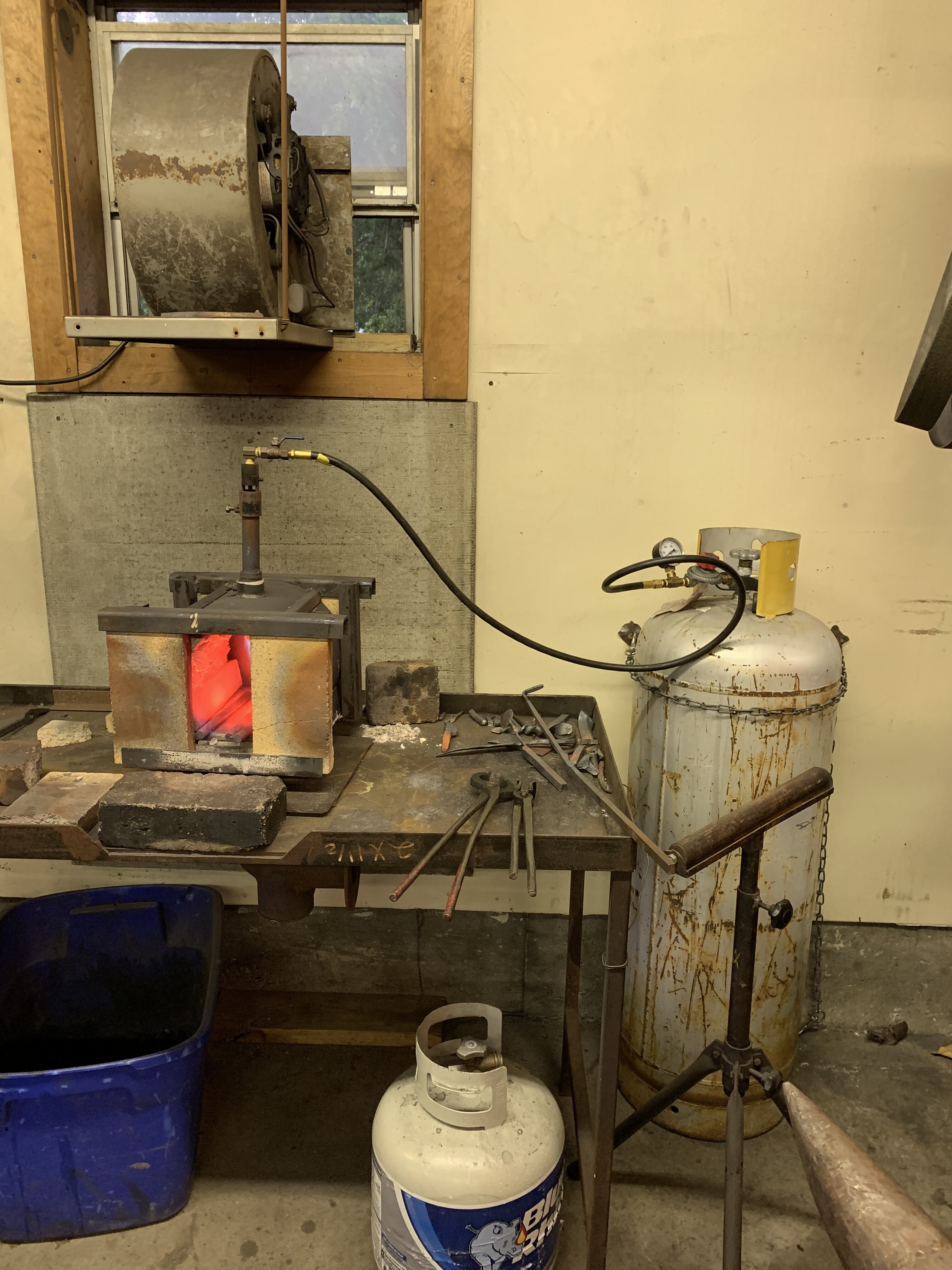

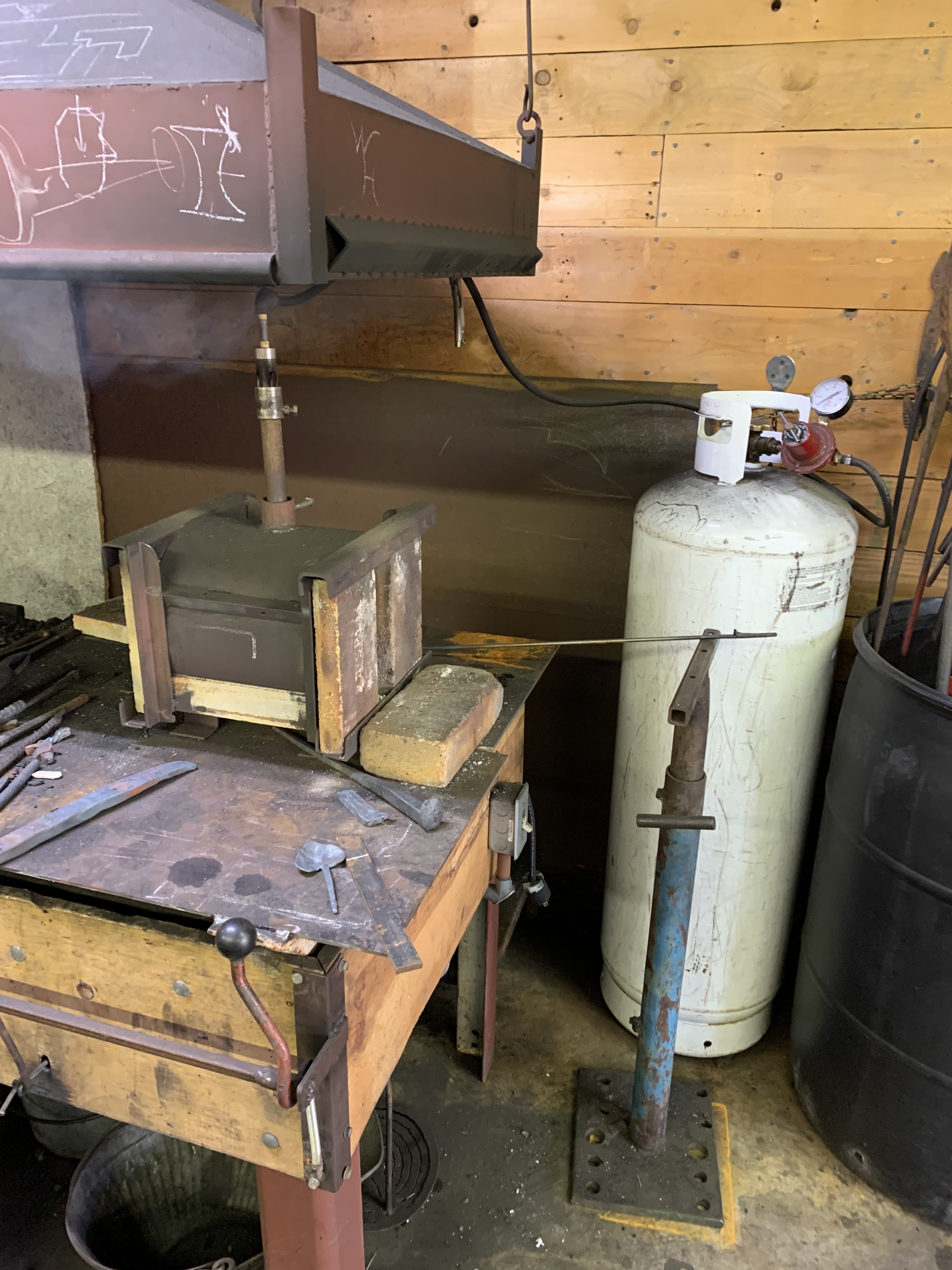

Might I make a suggestions that y’all visit the Blacksmith shop in Haysville and see the forges in action. And talk with some of the people who have built forges.
The Haysville shop is at 200 S Main St right past the Haysville library. It is open every Monday and Wednesday 6pm-9pm. The President - Larry Evans and/or the VP - Bill Moffet would be happy to give advice.
There are 4 gas forges and 2 coal forges.
Lee Crawford was talking shop with Rust when I showed up at the space tonight. It sounds like he is on board for helping set up a forge and I definitely appreciate it.
He has suggested that we go gas first since it gets metals hotter faster and more uniformly then solid fuels.

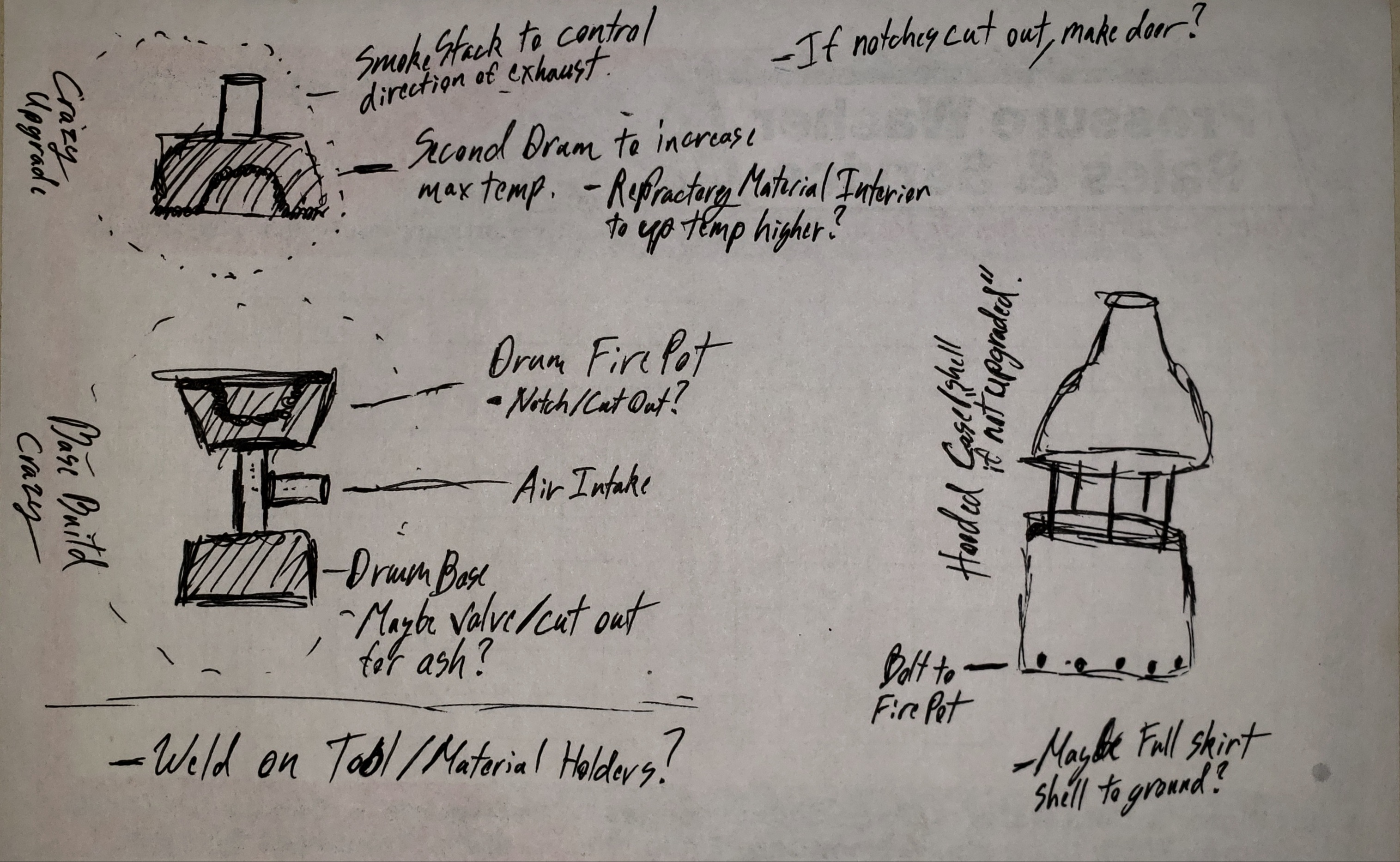

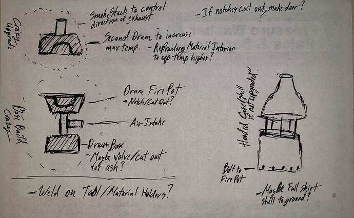

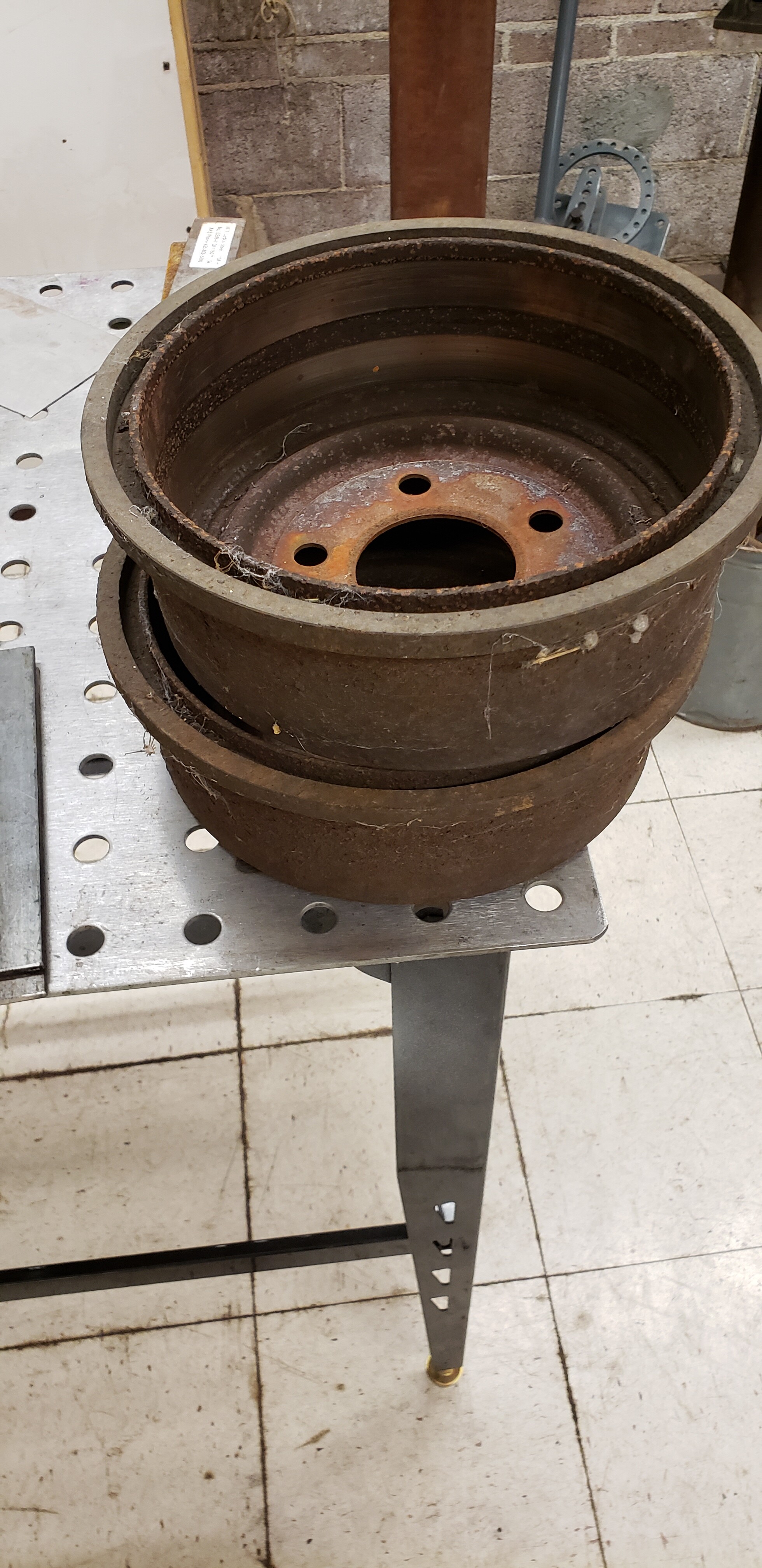

And thanks to Rust we have two old rusty former jeep brake drums begging to be two little forge fire pots.

I hope to make most/all of the forges mobile at the very least and collapsible and able to be stored into small areas, at least for the small solid fuel setups.

I’ll be in it, mainly to see if all my sketching and mock ups might be something or if its kindling for the fire pit.
