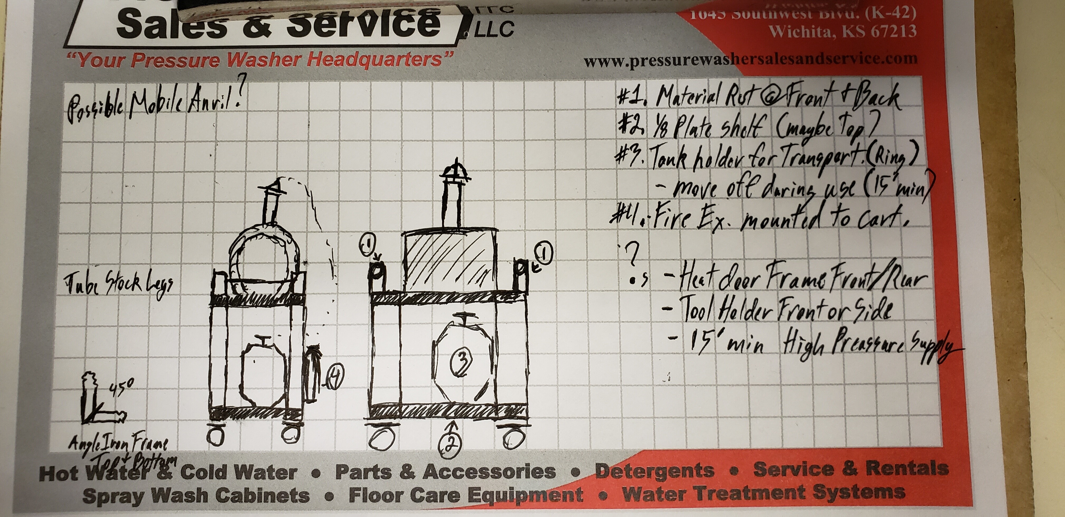

Coal forges will have to be 100% outdoors. I drew up a rough draft for a gas forge about 2 months ago and to keep up with the fire code we might have to make it mobile as well, at least if we use high preassure LP to fuel the burner.
This is for a single venturi burner using high preassure LP. I’m also toying with the idea of making a feature creeper 3 burner segmented forge that would let us do long/short pieces or work just depending on opening gates and igniting the number of burners needed. But that is an idea that will need some money and time donations to weld up.

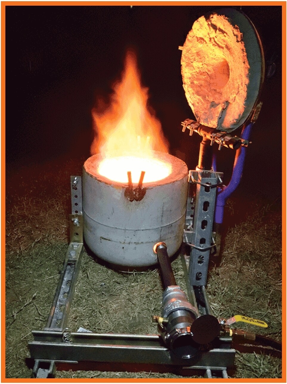

I have seen gas forges made from feon bottles.

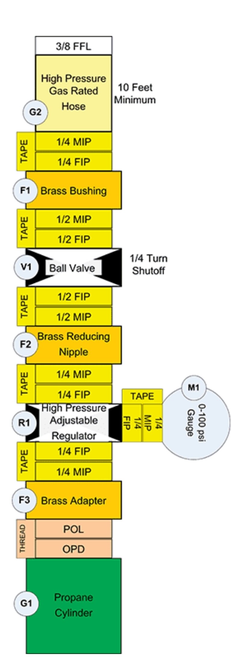

Anything thats big enough to support refractive material and the burner can be a gas forge. Its the gas supply equipment cost that makes it a bear to start with first.
This is from my Bible of Fire. We could probably go cheaper and get a 30psi max regulator since 60psi would be overkill for any forge for Make. After this is made then next step would be a burner.
Very satisfying fwoosh.

If possible set aside two of those drums (im assuming they are around the same size as bus brake drum) and a section of pipe and we might have a go at making a gas foundry. Maybe add casting molds to a list of Makes abilities.

From what was talked about during our kick off the big take away for the first forge was 1) mobile, 2) solid fuel, and 3) next to nothing for budget.
My train of thought is since we want it mobile instead of making one small boy that we can move but classes would have to hunch around we should make multiple so any class we do for solid fuel blacksmithing can learn by doing every part of an operation start to finish 90-100% hands-on. The thought of a longer/wider single forge has also crossed my mind but that might be more difficult to support.

That might be something. Its got an idea rattling around now anyway. Let me sketch and see if whats rattling around makes sense on paper.
