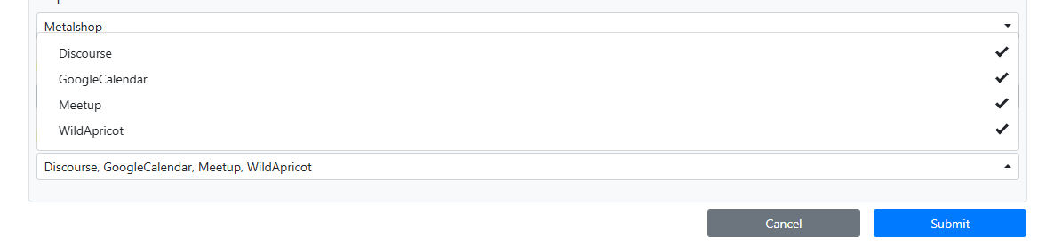

Remove meetup from the things that need syncing. (Tip: its usually meetup. I alerted the IT guys)

No. The text string should be fine. There is an option for the Meetup group that can be checked when you do Calendar, the forum(Discourse) and Wild Aprict. Pick that option and uncheck Meetup.
Uncheck “Meetup” here
Doing so for the MIG class seems to have worked.
