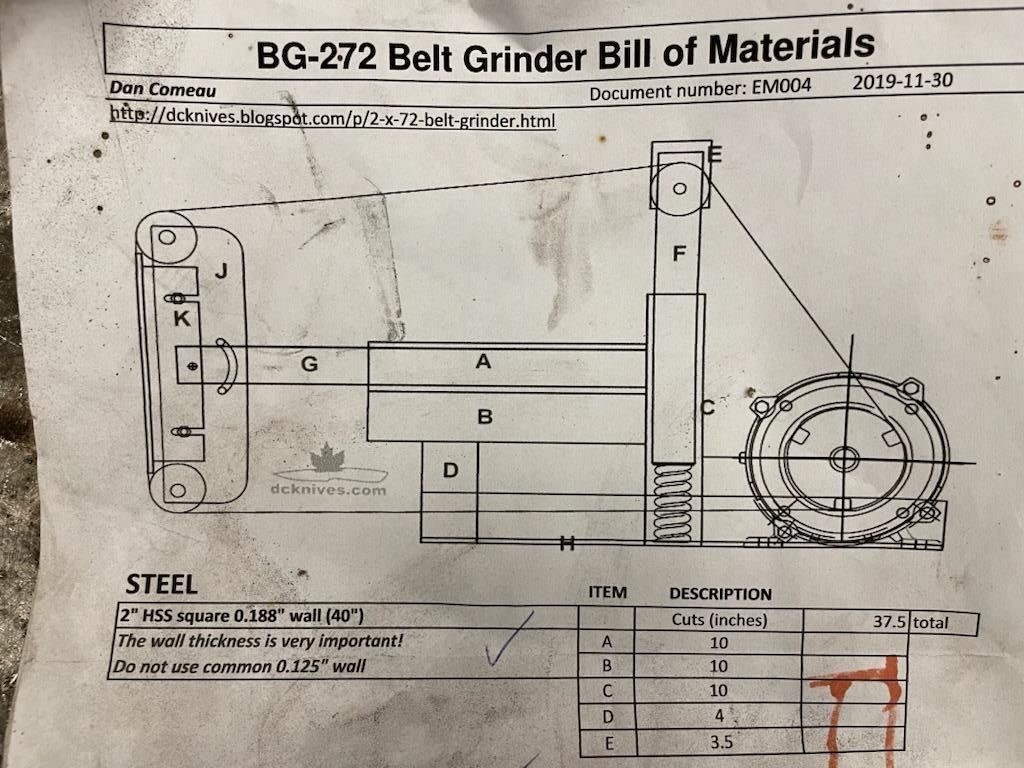

Thank you, @rustin.atkeisson . Here is a picture of the drawings you referenced that I found at MakeICT. These are the right ones, right? Sorry if the picture is huge.
I will continue this in another reply because I can only post one embedded picture per reply.

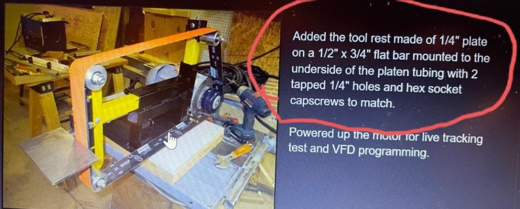

I went to the internet and found a picture where they had done what I want to do and attached a table to the grinder. Here is a picture of that as well as the dimensions of the materials:

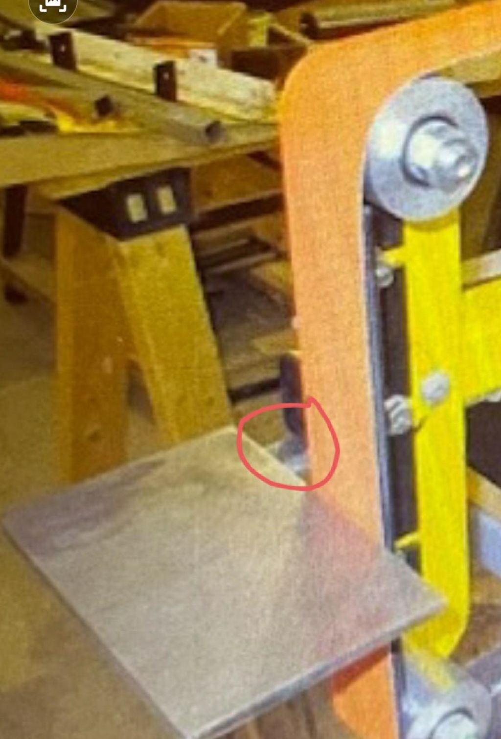

This next picture appears to be how it was attached:
They should have taken the picture from the other side so we could see it better.
I would like collaboration and approval before spearheading this on my own because this is not a tool that is owned by me. How would leadership like me to proceed?

Yes, those are the drawings.

I don’t think those drawings (diagram) show how to attach the table. Right?
The table bolts in to the lower tube.
I thought there was another drawing that showed how to make the table. If not, I think if you look up that model number from the drawing and I think they are considered public commons. So there shouldn’t be a charge for the drawings (I think)
