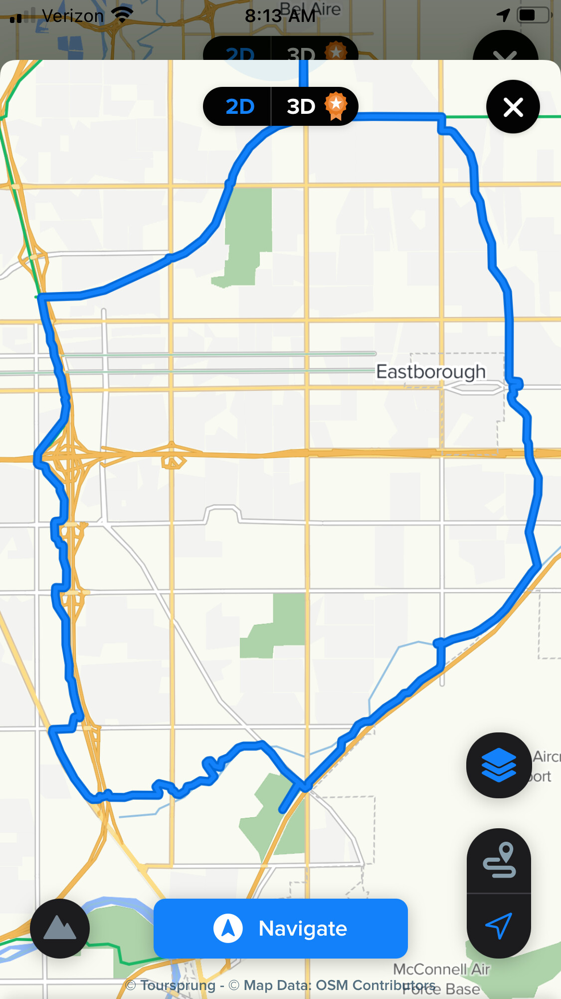

We went on our first ride together this morning: 24 miles. It was a nice workout for us but the batteries had plenty of range left in them. They were showing 75% when we got home. Tomorrow we will push it a bit further.
