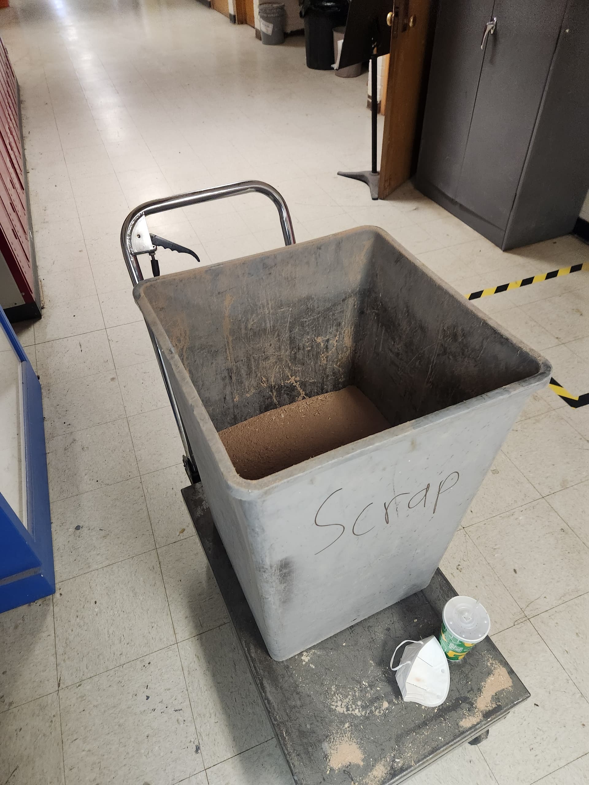

The dust collector is functional again. While the complete stoppage was due to the dust collector being run long after the barrel was full, the filter was clearly due for a cleaning.
This trash can was almost half full of fine dust just from the pleats of the filter.
