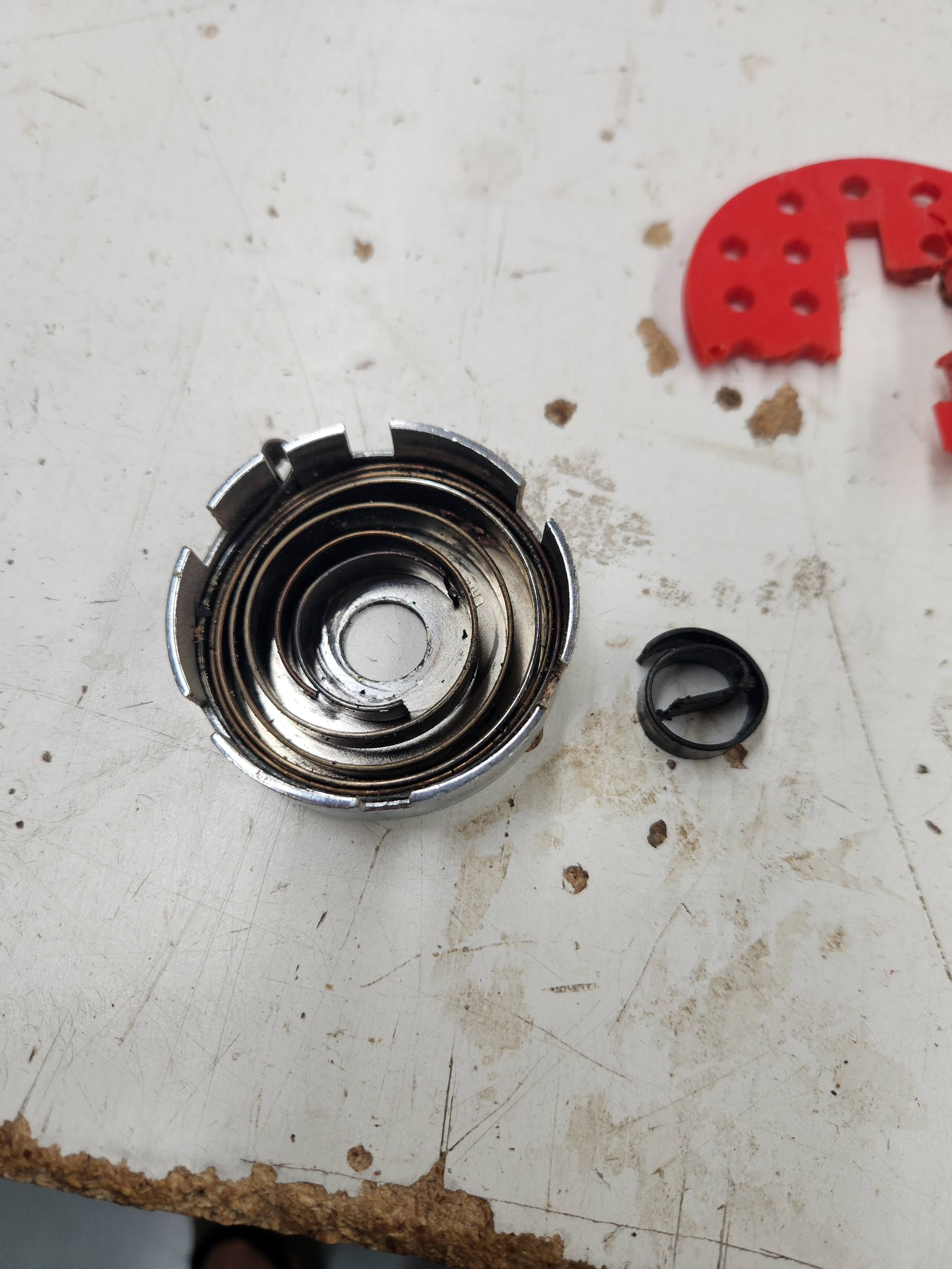

Drill press “return spring”. Might be broken. Press dropped while i was adjusting drill depth. Has to be manually held up before drilling anything. Something seemed to snap while i was checking range of motion.

Drill press quill return spring has been replaced and the drill press functions as it should.
