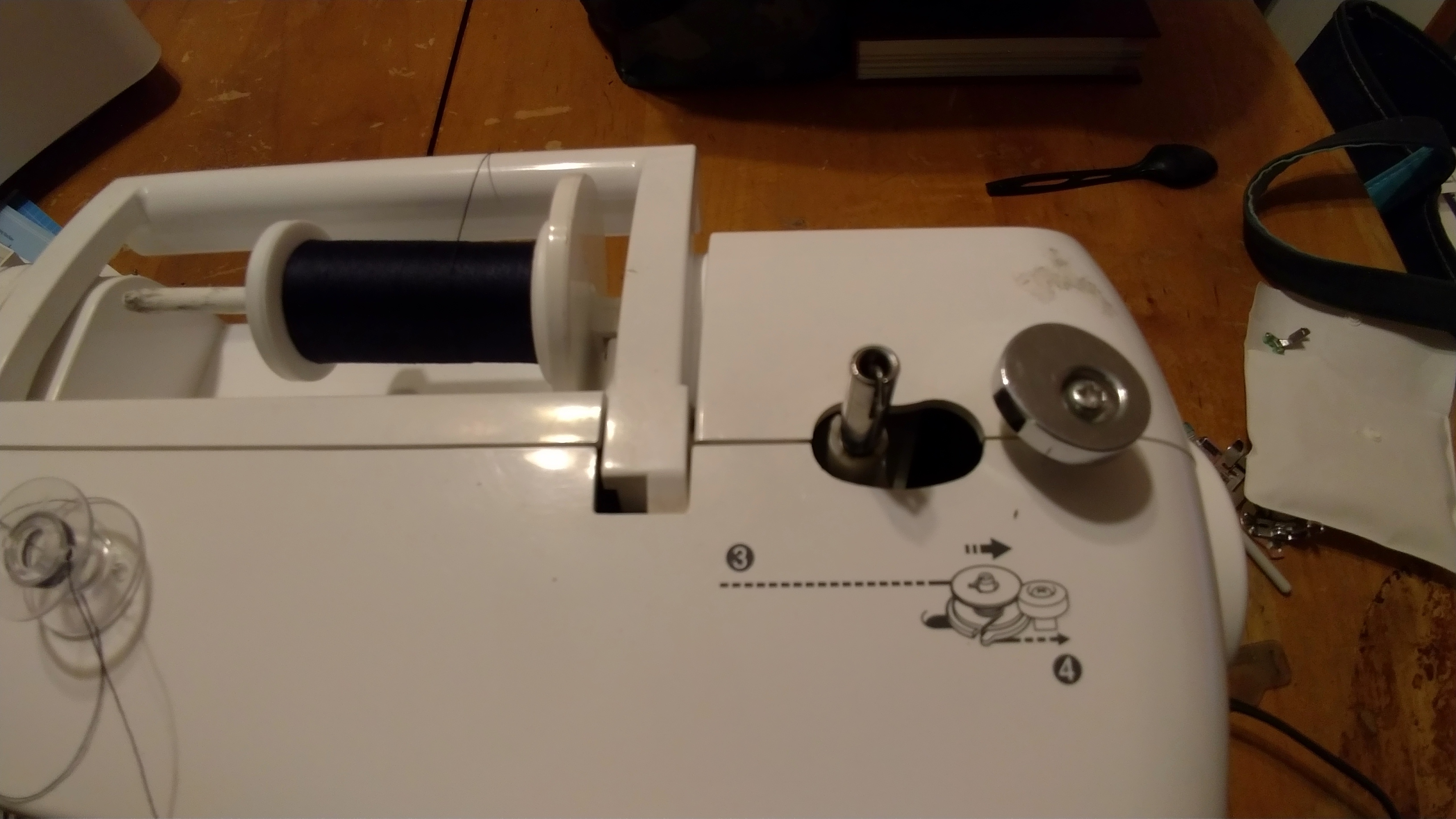

McDonald’s Sewing and Vacuum donated is a cs6000i and Brother SE-350 (4"x4") embroidery. I picked them up Wednesday evening and wanted to check the embroidery machine out, see what it needed and possibly write instructions. It does need the bobbin wider repaired. Maybe someone can design and 3D print a platform as the one that came with the machine looks to have broken off.
