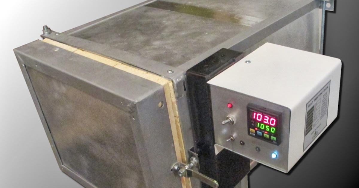

This is a link to plans that is what I’m looking for:
dcknives.blogspot.com
Heat Treatment Oven Project
Heat Treatment Oven Project After making my 3rd knife and finding it difficult to maintain 1000°C temperatures, sustained and accura…
I can dig out some code I’ve used for a aluminum melting kiln (which I tend to just use with a static cone now (purely as a safety, as it doesn’t and shouldn’t melt in use), as I realized I mostly wanted it hot, but I could use it for doing something like that) which controlled temperature, with a Solid State Relay, microcontroller, and a thermocouple. It is a ~120V kiln (which is a rarity, and if you have the outlet for it, I’d highly recommend a ~240V, as it will be a lot faster)
Cost was probably $250.
If temperature control is important the cheap way to do it is exactly as described, which is the non-DIY way to get the PID/microcontroller.
It’s also what is in the melting furnace in the cold metalshop/jewelry area is, and I think that cost like $600?
I have several kilns of questionable merits…
Get in contact with Central States Metal Artisans, they can give some advice in this area and would probably show you how on a propane forge.
