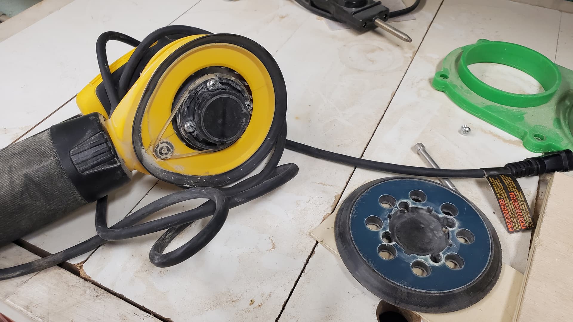

The hook and loop pad needs to be replaced. The hooks seem to be worn out. The pad is missing on the harbor freight one too.
@doug.wilson
I’ll pick up a spare. Thanks for the heads up.
Well I arrived this evening to find this. So it definitely needs some attention now.
It appears the following parts are also now needed.
DWB-N329082
DWB-N329083
These are available on Ebay for under $10 each. I’m sure they are available elsewhere, too, like the site the links go to.
I did notice that. I got the parts for pretty cheap and hope to make the repair as soon as the parts arrive.

The sander is operational again. Get sanding, ya’ll!
