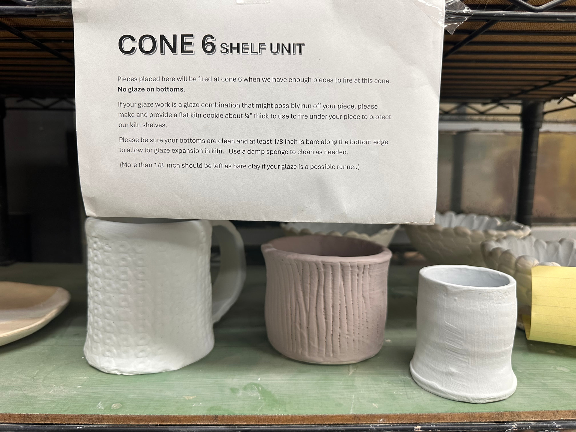

Here’s our posted information- it is clearly posted on the shelf.
The pieces above the sign are glazed clear to the bottom and can’t be fired like this at cone 6 or even 5. You need to wet sponge at least 1/8" rim at bottom edge- more if it might run.
We do not want any glaze to run onto our kiln shelves.
