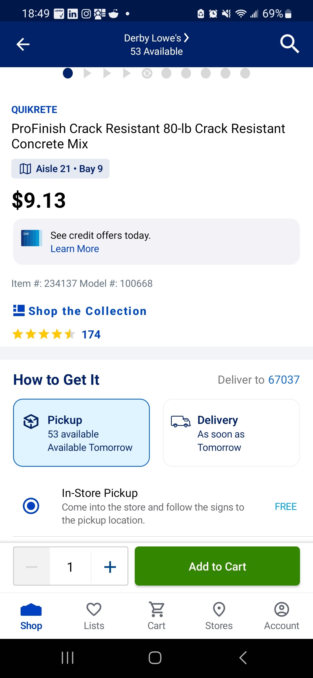

I looked at Lowes and home Depot. You have to order it.
The app says that Derby Lowe’s has 53 ready for pickup.
This is the one Mike linked.
Same for E.Wichita location.
