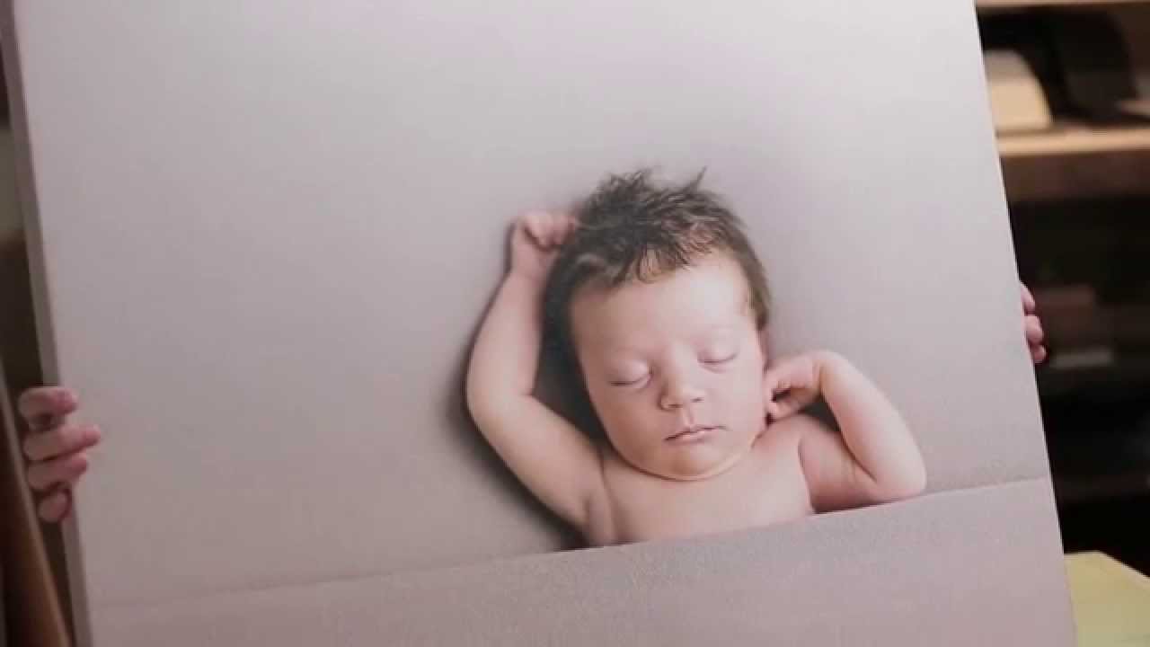

You’ll need:
The printed canvas (Make sure to print about an inch or 2 extra on all sidea for a gallery wrap).
A blanket or something to cover your work bench to protect the print since it will be in contact with the workbench a lot.
Stretcher bars. They are the wooden back frame pieces. You can make your own stretcher bars, but to really do it right you’ll need to use a router to taper the inside edges or eventually you’ll be able to see damage to the print cause by the inner edges of the wood. They are sold premade at hobby lobby with routed edges. Download the app and get 40% off like almost all the time.
A staple gun. Preferably automatic. I bet your hand would be killing you if you tried a manual one.
Canvas stretcher pliers. They make wide ones and less wide ones. I use both. The wide ones give a good wide pull in the centers. The smaller ones are way better for corners.
I didn’t watch the video above but the process is pretty simple to watch, and probably drawn out to try to write.
But essentially you want start in the middle. On the longest side. Position the canvas and add about 3 staples. Then stretch from the opposite and add 3 staples. Then repeat the stretch and 3 staples for top and bottom. Be aware of the tightness of the canvas all around as you work. No wrinkles or looseness.
The corners are a bit trickier. I’m not going to explain that in detail actually. But you want to make sure they are really right. I staple under and over the 2 pieces of corner canvas to make sure they are perfect.
