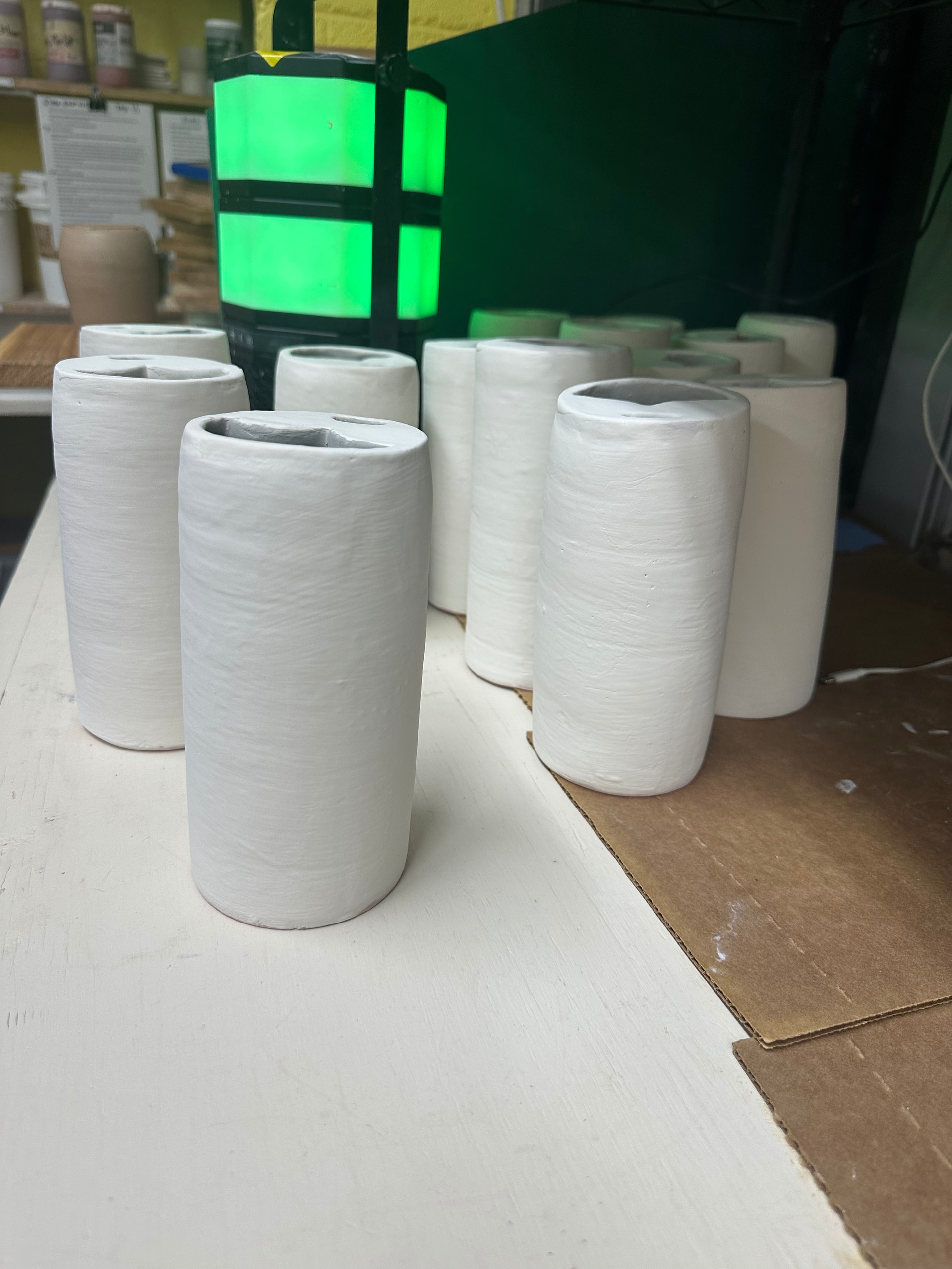

Can’t fire these with glaze on bottoms
Edit- we had time to clean the bottoms for you. We got all we could in this kiln load- but couldn’t fit them all in this time.

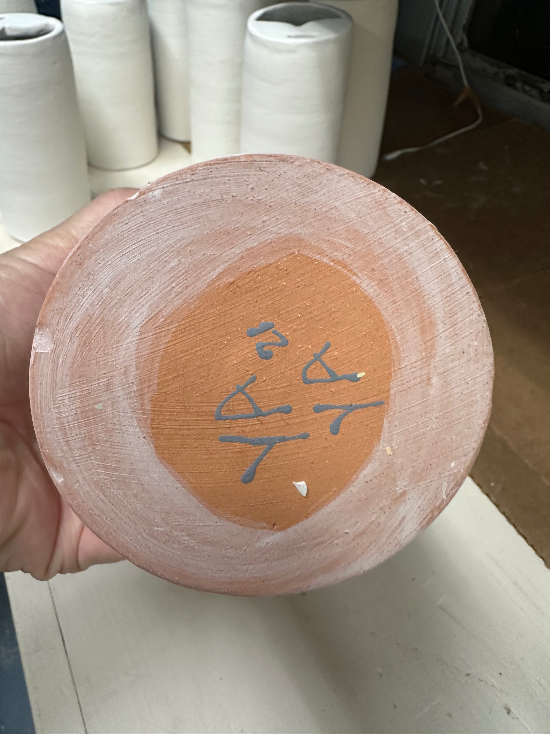

These pieces still have some glaze on bottoms. We can’t fire these like this without risk of them sticking to our kiln shelves.
Is the writing underglaze or glaze?
And the white glaze needs to be completely cleaned from bottoms and there should be at least 1/8 inch bottom rim free of glaze for cone 6.
Thanks. I was going to head over and clean them up again rn but thanks for taking care of that. Its underglaze!
