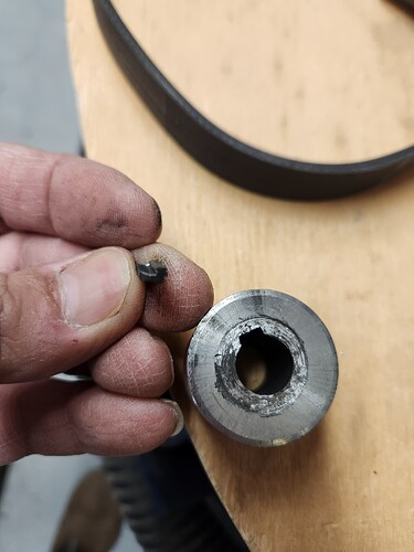

I stopped by this evening and looked at the saw. The driven pulley for arbor is worn and the key is nearly sheared off. This has been getting this way for awhile. If parts have not been ordered, I would like to do so, or for @doug.wilson to do so. I can fix it once the parts arrive.

Parts are ordered. Hopefully they’ll be here in time for me to install them next weekend.
Parts are still enroute. They shipped via UPS mail innovations which roughly translates to slow boat to Timbuktu before it gets on the slow boat from china. So far it’s been almost a week for the parts to get to Wichita from Arkansas and they’re not here yet.
ETA: looks like the parts will be here on Monday.
Bosch miter saw is fixed.
