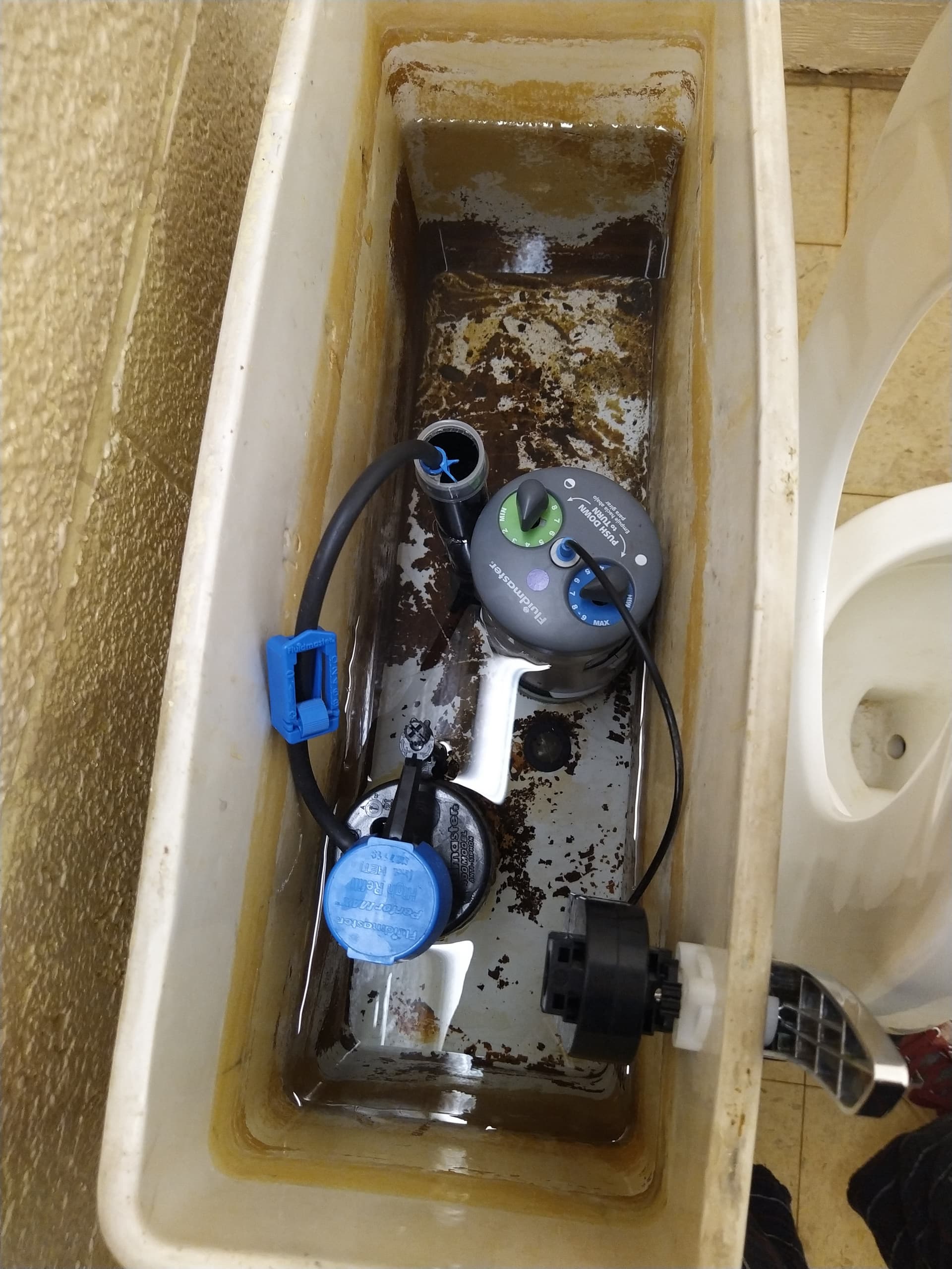

The original bathroom by the office was running this morning. Not sure how long it had been in that state. A couple of jiggles and pulls and I was able to get it to stop. I left the lid off the back as a warning. Hopefully someone with more skills than I have can fix it.
That… is not the flapper I was expecting. You’re going to need an air force tech for that one.
Yea, it’s been that way for quite some time … though it has been doing much better recently. It used to get stuck on every time it was flushed. We really just need to completely replace the guts.
What is it that gets stuck? On the flapper style the chain often gets tangled but I can’t tell what might be the cause on this style
Ughh. That’s an overly complicated setup that uses uncommon parts. It looks like the flush handle works a cable instead of a chain. And that the flush valve, instead of a flapper has multiple adjustments and rides up and down a tube.
Gutting and starting with conventional components is the recommendation I would give.
A complete conventional kit probably costs less than any one if the three main parts for this setup, and would certainly be less maintenance over time.
Unless one of our members is familiar with this setup it’s not worth messing around with, and should be just downgraded.

This is one of the toilets that you lift the handle for one use or push the handle down for the other use. It limited the amount of water used if there wasn’t much to flush. Originally there was a note on the tank cover.
I’m generally all for innovative things like that but since there’s no onsite maintenance and this is something that could potentially go unnoticed for days, I would support replacement with more reliable and easy to fix hardware.

The handle works itself loose then the box on the back of the handle comes loose from the base and it stops engaging the cable correctly. I think a silicon / rubber washer was left out of the install to allow the handle to snug up and not work its way loose.
I have the same unit at home and once adjusted it works well. I also have a spare unopened unit if we need replacement parts.
