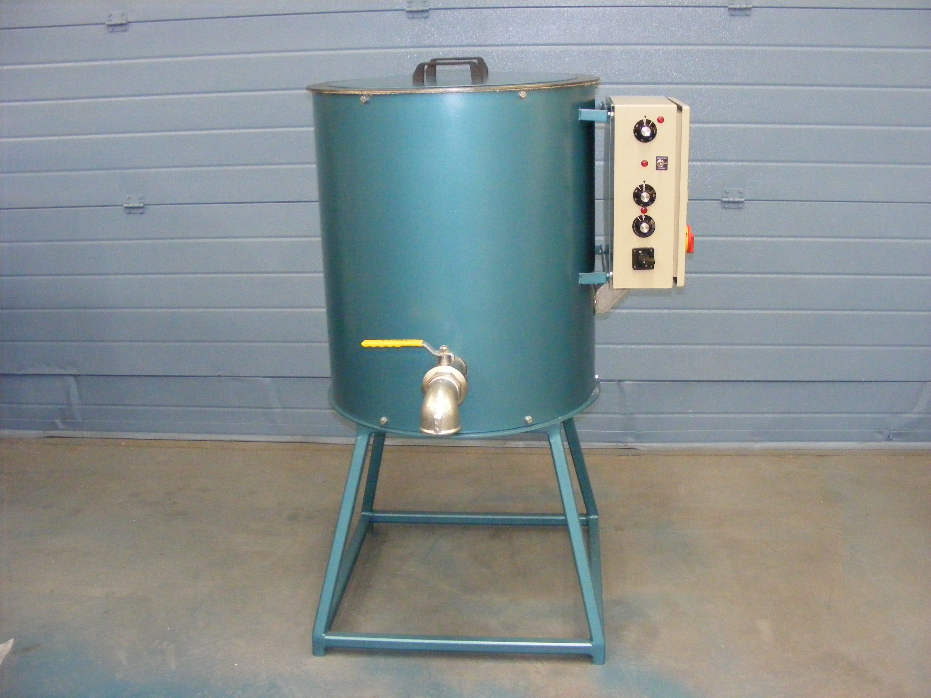

I just got off the phone with somebody about this and he told me to take a look at something like this:
Maybe this is a crazy idea… I don’t know… how about putting it in a vat of heated water… then the temperature wouldn’t exceed 212. That is the way to evenly heat chocolate… double boiler.
That amount of heat 1750 watts is about the same as a counter top heat plate or a small toaster oven. It not only would not be enough heat for a barrel, but even if you stacked up as many as would fit on one barrel, not enough heat would get to the center. How many pounds of wax are you wanting to melt? And, how long of a time from turning it on to being able to pour meets your requirement for it being fast?
