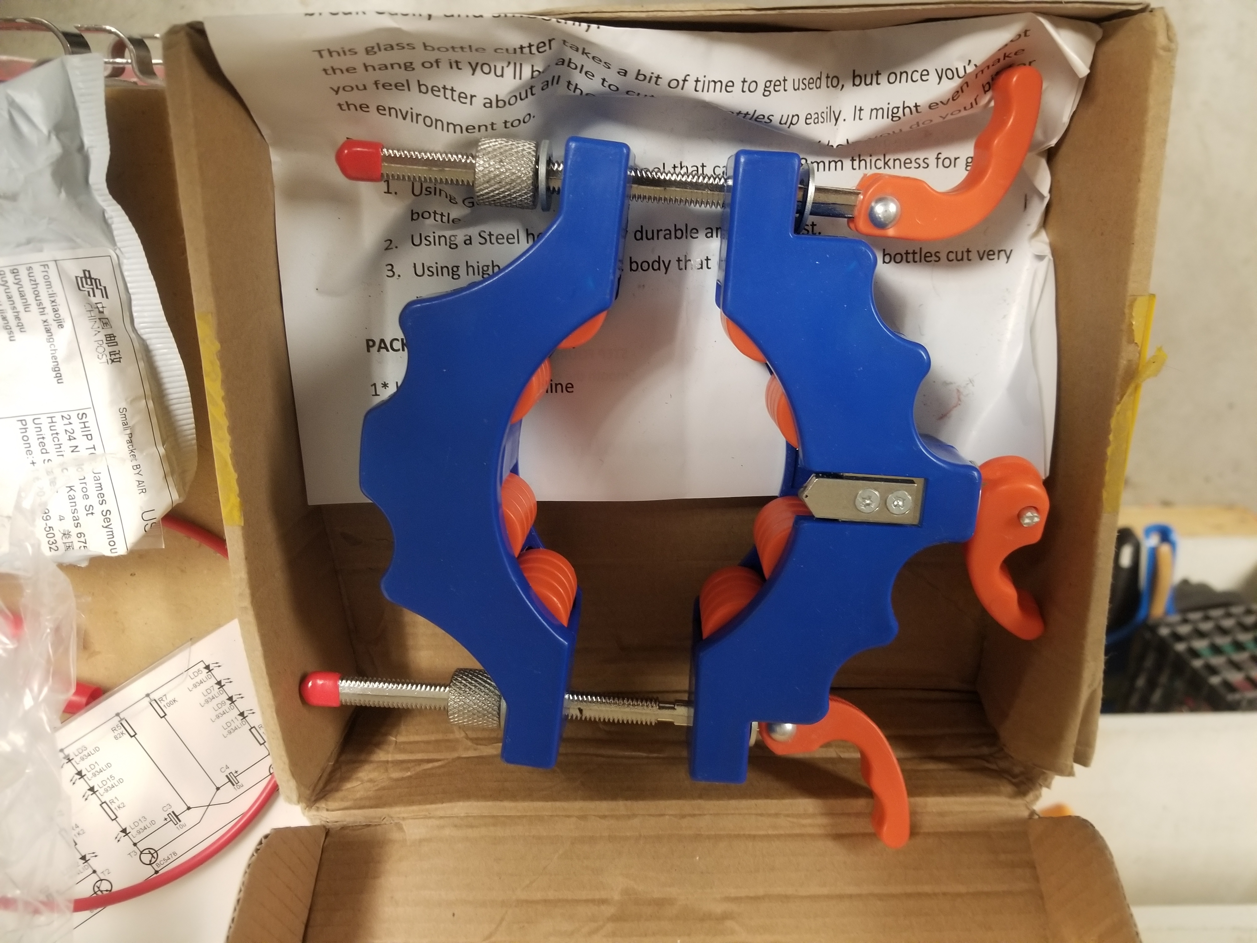

I’m wondering if anybody has a glass cutter, preferably diamond wire, I could use at the shop for an afternoon. I have some glass tubes, about 3" diameter I need to cut to shorter lengths. My design isn’t finalized, so I don’t know when I would need it, I’m just planning currently.
They’re about 7 ft long. I’m still working out design, so I’m not sure how long I need the pieces to be after cut. It’s possible I could score and break them so they’ll fit in the laser, then cut them to the appropriate length with that. Not sure how all that works, though. I didn’t think the laser was hot enough to actually cut glass, just etch it.

Depends on your definition of ‘cut’. Glass tends to fracture when you attempt to cut it with the laser. It doesn’t really like being rapidly and unevenly heated.
So in the past when I use the lasercutter I made a line like 10x longer than the circumference of my bottle (I was cutting beer bottles) then t l used a lower power and higher speed. That stressed the glass over and over in the same spot, and they would just pop apart in your hand.
