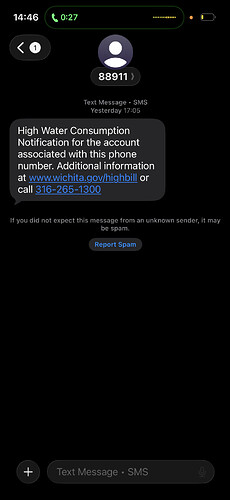

I got a text about unusually high water consumption yesterday that I was most confused about as our property that our home is on is well water.
After an hour on hold with the city of wichita apparently my phone number is associated with our water service at the makerspace.
(attachments)
