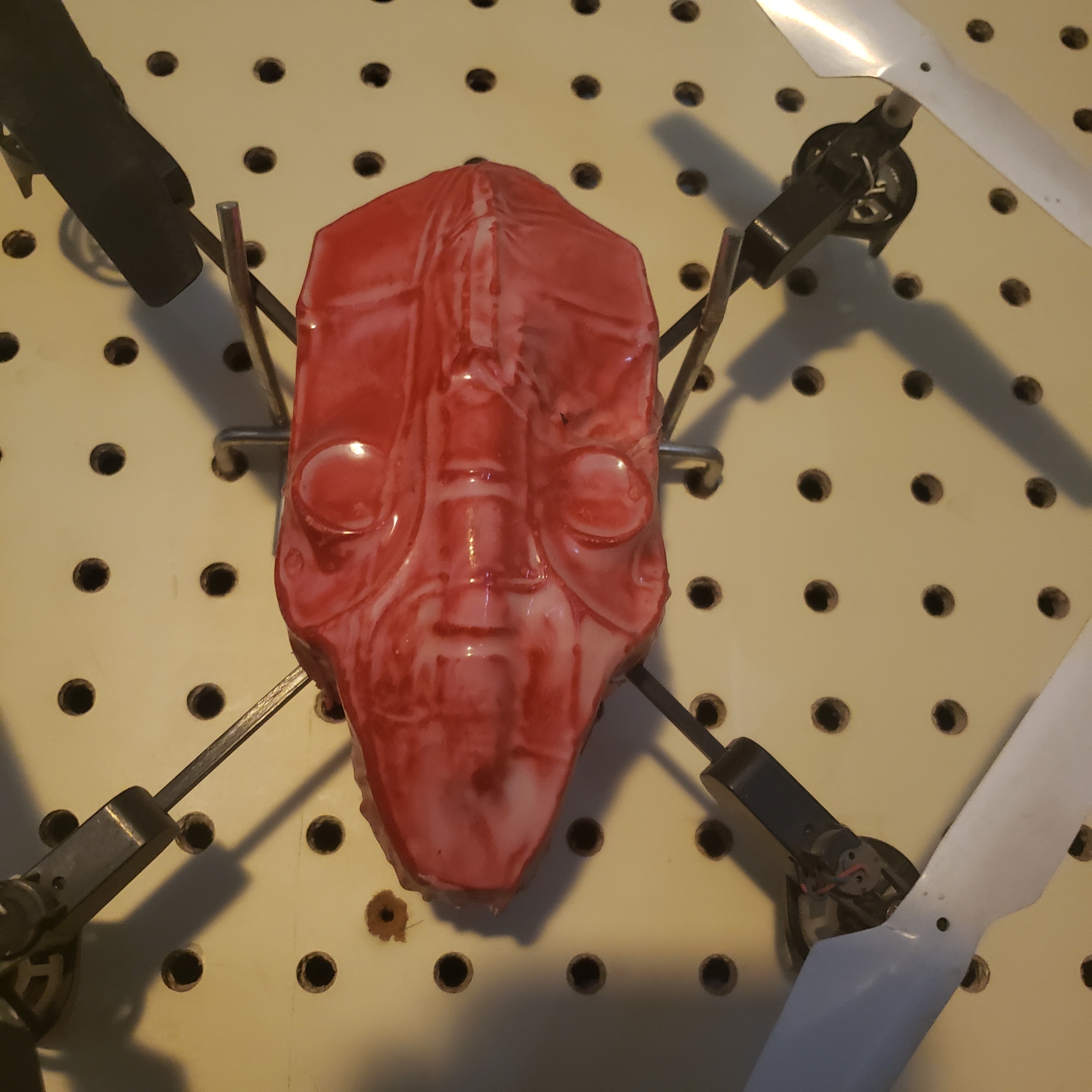

I’m interested in this too I have made some make shift rc drone bodies using a shop vac. And a box table with aluminum top that has holes in it. I built form out of plaster of Paris reverse engineering the existing body. For plastic I used recycled plastic containers and a heat gun to form/heat it
It had suprising decent details
