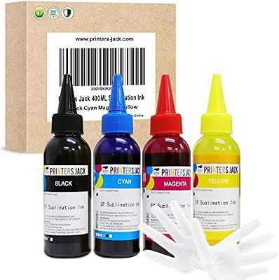

Techniques on the cheap you can convert a 200$ inkjet like Epson ecotank et-2720
And buy sub ink refill online 25.99$ set
Works good enough for photos from what i see
Printer must be new with not ever having inkjet ink in it
